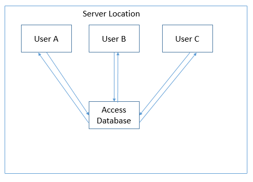

Hi, I have created a macro file that will store/upload the data to the database. Users are sitting across the country. I have given a separate folder for each user and kept the macro file. I will explain with a below example.
A is Admin(me). B , C D are the users.
Separate folders in the server location has been created for B, C & D users by Admin.
Folder created for Access database in the server location and B,C & D are have the full access to their respective folders and Access database folder.
User B is updating some entries in the Excel. After updating B needs to click a button to run the macro. Now my macro will push those information to MS Access database.

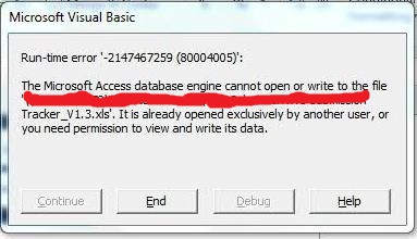

After clicking the button, some times info uploaded to the database.
First Problem : Some time it shows below error and the user input not uploading the data to the database. Instead of I can see come blank rows added in the access database.

But when cnn.Execute sqlstringis running the copy of the same Macro workbook is opening as read-only.

    Here Front end is Excel... Backend is MS Access. Macro written in the Excel.
    User can't even see the MS access database.
    They can can update only in excel.. Everything will be captured in Access through Excel VBA code.
    And My users are having access only to their folder and they can access the file which is available in their folder.
    Ex: For A - there is a folder available called A. In that have kept the macro file. Same for B. A can't access B's folder or files. Below is the quick workflow.

    Again - your error is referring to some Excel file named Tracker_V1.3.xls. That file is apparently locked by some other user or process.
    If that Excel file the "frontend" for your Access database?
    The concept of not using Access across a WAN and/or VPN still stands, regardless of the FE you're using to connect to it. Access is not a good choice for this type of environment, and you'll find it gives more troubles than it's worth. If all you're doing is storing data in the Access database, then consider switching over to a server-type database (like SQL Server Express, which is free) and use that instead of your .accdb format.
