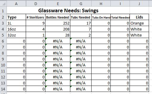

I have a workbook, Sheet1 looks identical to this this sheet, but this sheet copies the cells from Sheet1. My question is how do I auto hide rows if the cells in column A are "0"? I know there's some magic VBA code to do this, but I have no experience it the arena. Not apposed to using it, but if you have any suggestions, explain it to me as if I were a child. A very, dumb child.

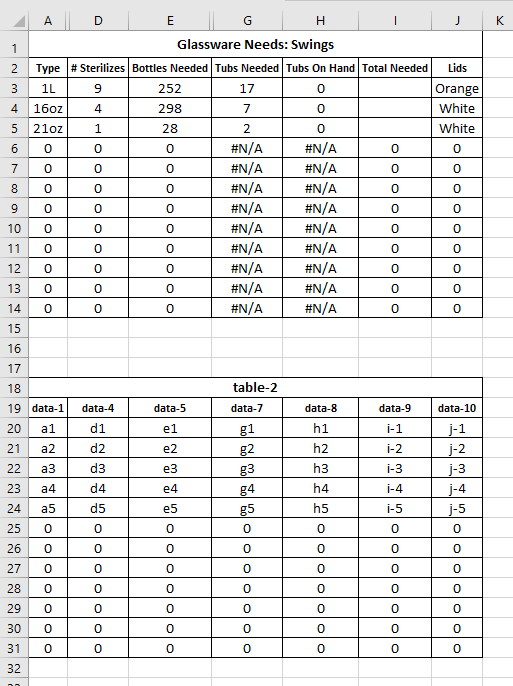

    Assuming that you have, on Sheet2, two (three-four,...)  'tables'
    as below
    pic-1
    table1 in A2:J14
    table2 in A19:J31

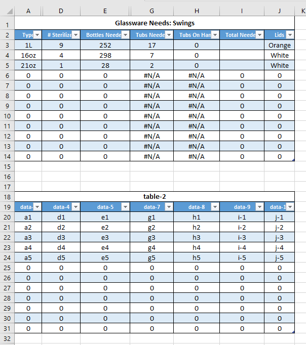

    convert the above ranges to REAL Tables
    select each range separately,
     from the ribbon select Insert > Table
    result:

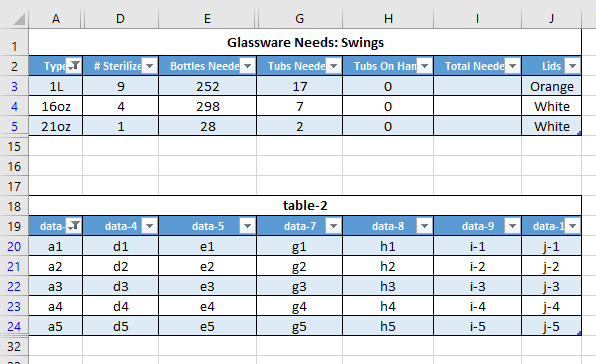

    final result (without zeros)
    pic-3

    Sub Update_ListObj()
    'Oct 01, 2016
    Dim ws As Worksheet
    Set ws = Sheets("Sheet2") '<< tables on sheet2, change name as needed
    For Each obj In ws.ListObjects
    obj.Range.AutoFilter field:=1
    obj.Range.AutoFilter field:=1, Criteria1:="<>0"
    Next
    End Sub
    step4
    To run the macro, press ALT+F8,
    select *'*Update_ListObj' from the list and click the run button.
