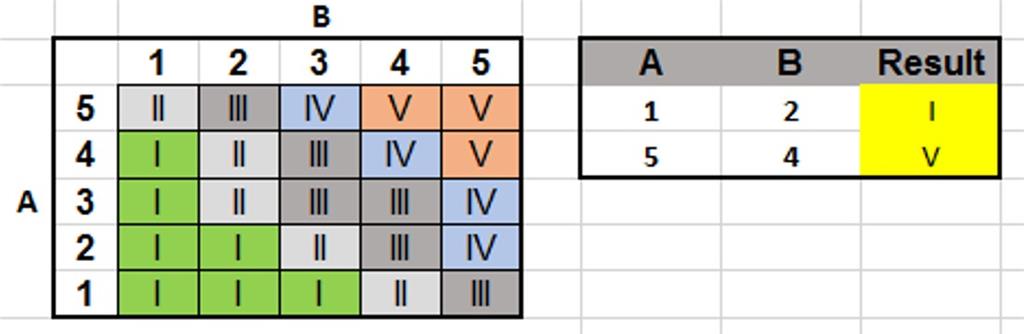

Would anyone have a solution for this problem. I have two features which together should give a result based on a matrix like this:
I would need a formula for yellow cells.
So far I have tried:
=IF(AND(A1=1;OR(B1=1;B1=2;B1=3));"I";IF(AND(A1=2;OR(B1=1;B1=2));"I";IF(AND(A1=3;B1=1);"I";IF… etc.
But that end up to an error: "This formula uses more levels of nesting than you can use in the current file format"
I also tried to use numbers A * B (equal to, smaller/greater than) but the problem appear with numbers 4, 8 and 10 since the matrix is not linear.

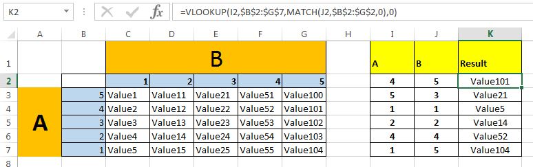

As per my screen shot, give this formula at K2 and copy it down.
=VLOOKUP(I2,$B$2:$G$7,MATCH(J2,$B$2:$G$2,0),0)
