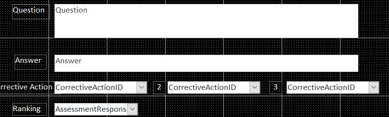

I have a form with a combo box offering multiple selections of "Corrective Actions" (cboCorrectiveActionID) - options are based on the CorrectiveAction table. Each corrective action has a CorrectiveActionID. The CorrectiveActionID is being stored in my AssessmentSessionDetail table.
Now I need to have multiple possible corrective actions so I have created two more Corrective Actions combo boxes based on the same CorrectiveActions table.  I have added two more corrective actions lines to the AssessmentSessionDetail so now I have "CorrectiveActionID, CorrectiveActionID2 and CorrectiveActionID3. Note that the user may not use all three combo boxes.  Sometimes one, sometimes two and sometimes three corrective actions could be chosen.

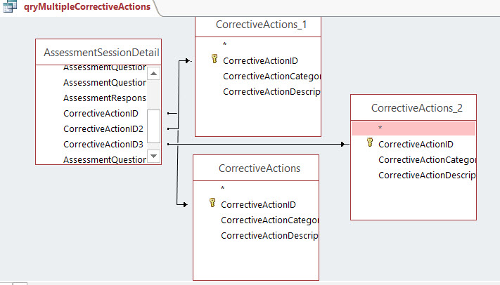

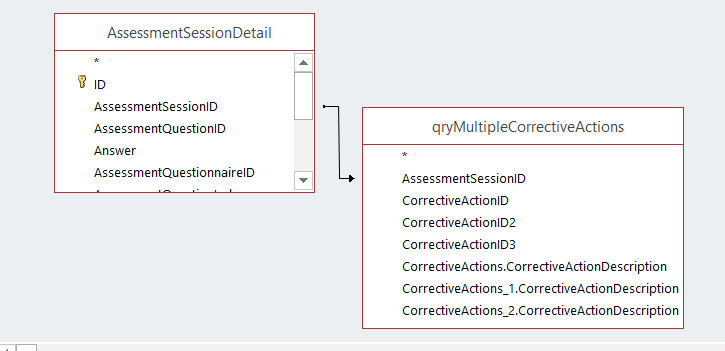

The process works fine in that the three CorrectiveActionID numbers are being stored in my AssessmentSessionDetail table.  However if I create a query I need to add the CorrectiveAction table three times to the query in order to display the three possible choices.  The problem is that if I use that query in another query I get multiple duplicated records for the results.  I am thinking that each time there are one or two additional corrective actions added via the new combo boxes Access is duplicating the record.
I tried creating three separate queries, one for each possible selection, but the resulting recordset is 53,000+ lines vs the 104 lines that should be returned.

    Can I use multiple combo boxes?  This is the way I had envisioned it:

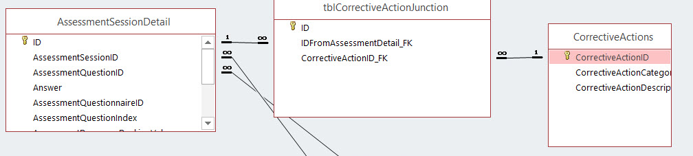

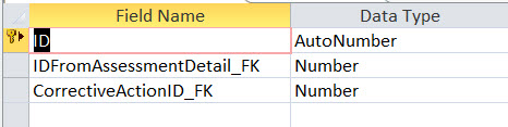

    Thanks Scott - Sorry for being a bit dense here...I created this table:
    And this relationship:
    I looked at some tutorials and they all use a datasheet view for the subform whereas mine is single form.  Is it possible to use this methodology for singe forms?  If so, how would I set up the combo boxe(s) on the single form?
    Thanks!

    "Now I need to have multiple possible corrective actions" This means you have a many to many relationship. One item can have multiple corrective actions and one corrective action can apply to multiple items. The proper way to model this relationship is with a junction table:
    tblItemCARs
    ItemCarID (PK Autonumber)
    CorrectiveActionID (FK)
    AssessmentSessionDetailID (FK)
    Whenever you start numbering fields (CorrectiveActionID1, CorrectiveActionID2, etc.) You are creating a repeating group which is a violation of normalization rules.
