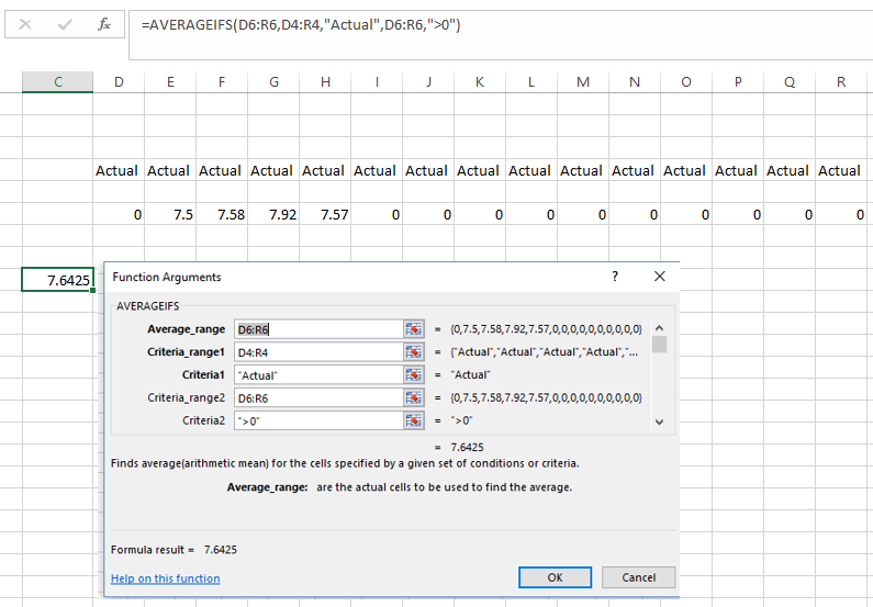

As you can see, when I open the dialog box for my formula it says the formula result should be 7.64. But once I press the "OK" button it instead shows the result of "0". Not sure why it is not working. My formulas are calculating automatically and I have actually switched it to manual then put it back to automatic. I have pressed the "Calculate Now" & "Calculate Sheet" button and both did not change anything, the result was still 0. I have actually deleted the formula then hand typed it back in again but it is still not working. I need this formula to work, I use this for payroll. It's so much easier if this formula would actually work instead of me doing a regular "=average" formula because I do not want to add the weekend zero hours into the formula.
Any suggestions for what to do? Thanks in advance!
Update, I found more formulas that are not being calculated even though I did the same as above. It's not calculating a simple formula "=sum(C6:R6)" I think it might be glitch/bug inside my worksheet. I guess I'm going to have to re-type my whole worksheet over again. I'll update if the problem stays.

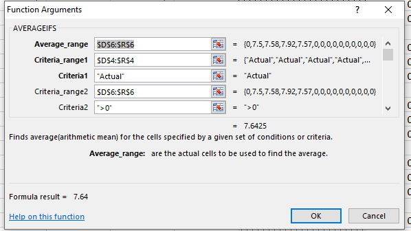

    I cannot reproduce this - see screenshot
    Can you post the file to OneDrive or similar file share site.
    OR would you are to visit my website (see people..... at bottom of this reply), get my email address and send me file by private email?
    Meanwhile try
    =SUMPRODUCT(--(D4:R4="Actual"), --(D6:R6>0), D6:R6)/SUMPRODUCT(--(D4:R4="Actual"), --(D6:R6>0))
    best wishes
