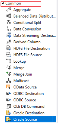

  1. Yitzhak Khabinsky 26,586 Reputation points
    2021-07-28T13:17:49.033+00:00
    Hi @hosein alirezabeigi ,
    If you have SQL Server 2019 with SSIS, Enterprise edition, it is much better to use Microsoft Connector for Oracle. Here is the link: Microsoft Connector for Oracle
    It is pretty good, and even doesn't require Oracle Client installation.
