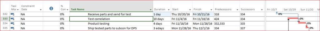

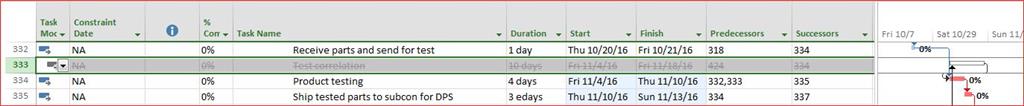

Hi - I am using Project Pro 2013.  I noticed that the inactivate task feature is not working for me as expected.  When I inactivate the "Test correlation" task as shown in the attached images, the dependency of the following "Product testing" task to the "Test correlation" is not removed.  Is this behavior expected?  I believed that the inactivate task function would effectively remove all dependencies to other tasks, but this does not appear to be the case.
In my example below, "Product testing" does not move to 10/21 when the "Test correlation" is inactivated.  Instead, the task only moves to 11/4, which is the start of the inactivated "Test correlation" task.
If dependencies are retained, and only the durations of inactive tasks is removed, then the inactivate task is not a useful feature for me.

    Unfortunately I don't have Project 2013 so I'll have to turn it back over to Julie for comments thereon. However, I suspect the behavior in Project 2010 is faulty and it was consequently fixed in Project 2013. Why? Because in the example, if Task C is driven by Task B and Task B is driven by Task A, if Task B is inactivated I would logically expect Task C to inherit the predecessor to Task B. In Project 2010, it does not, but it appears that in Project 2013 it does.
    So, I would think that the way Project 2013 handles this scenario would be of more use to you than the way Project 2010 handles it but in your initial post you indicate that is not the case but I don't understand why.

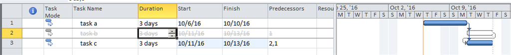

    At any rate, your memory of how this plays out in Project 2010 is not quite right. Duration is not set to zero and the dependencies are still intact although their effect is removed (see screenshot below).
