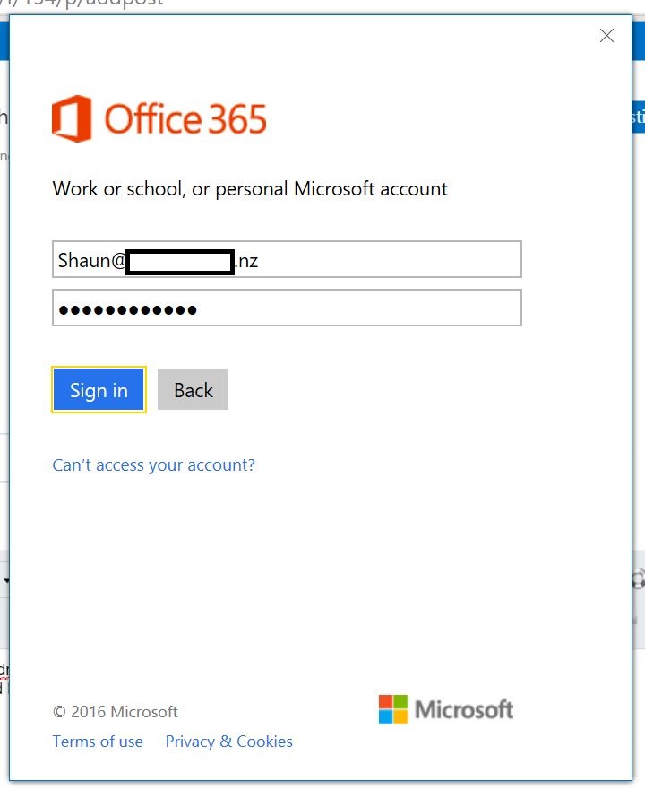

all of a sudden today i noticed i have a credentials problem with onedrive for business. when accessing a file from my synced sharepoint directory it will say i cannot open the document from the server. the icon in the right hand bottom tray says i have "we need your credentials to sync some libraries" with a blue "enter credentials" button. when i push the button and follow the instructions it comes up with a screen below. when i enter my password nothing happens. it just hangs there (note i can still log into office 365 from a browser so not a password or user name issue)
firstly, why should i have to enter my credentials and secondly why is now hanging on this log in screen.
