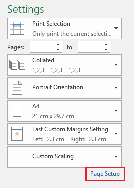

    1. Open Excel, go to File > Print > Page Setup.

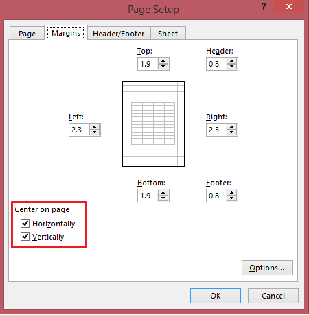

    1. Click Margins tab and set both left and right margins to be the same, top and bottom margins the same. And select all in Center on page.

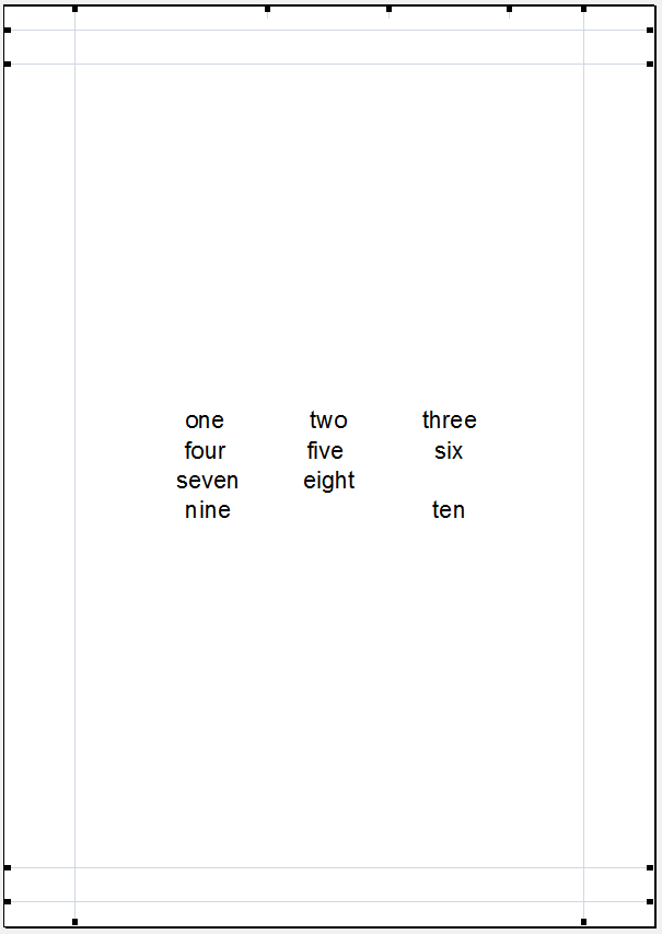

    Ideally, as long as the margins are the same, you can print double sided symmetrically as the example below.
    Actually, because printers have different default settings, the page may not be exactly symmetry. To solve this, you need to do tests to adjust the margin setting.
