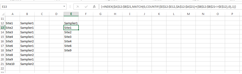

Hi TimothyVale,
You can use the below mentioned formula to get the desired result.. It is an array formula. After typing the formula in the required cell, you have to press Shift+Ctrl+Enter for getting the result..
=INDEX($A$12:$B$21,MATCH(0,COUNTIF($E$12:$E12,$A$12:$A$21)+($B$12:$B$21<>$E$12),0),1)
(here data is in A12 to B12) See the below pic for more clarity..

    Hi Tim,
    It is working fine for me.. Can you share me the Excel file, so that I can check the same and get back to you..
