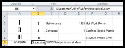

Path in B5 of the 1st workbook:
S:\common\HPM\Safety\Historical.xlsm

    I have B5 selected in the screen cap below.
    The debugger hangs on the line I have bolded.
