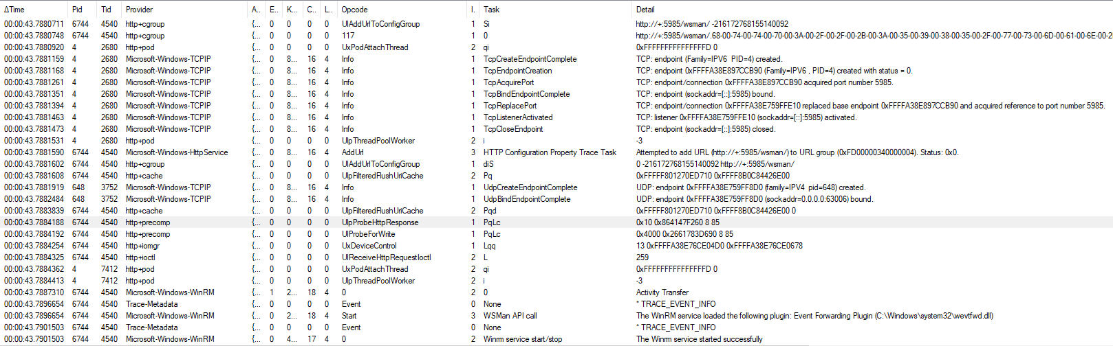

    • Start a ETW trace on the system where the WinRM listener is running with the command netsh trace start provider=Microsoft-Windows-WinRM provider=Microsoft-Windows-TCPIP keywords=ut:Global,ut:Endpoint,ut:TcpipEndpoint,ut:TcpipListener,ut:TcpipBind,ut:ConnectPath level=4 provider=Microsoft-Windows-HttpService provider=Microsoft-Windows-HttpEvent provider={20f61733-57f1-4127-9f48-4ab7a9308ae2} keywords=0xFFFFFFFF level=5 report=disabled tracefile=why.etl
    • Restart the WinRM service.
    • Stop the ETW trace with the command netsh trace stop
    • Either analyse the why.etl file yourself or make it available here.

    This is the key sequence of the trace and everything seems to proceed as expected:
    One would not expect to see explicit mention of an IPv4 address in that trace; the addresses that are shown are all zeroes addresses and just displayed in IPv6 format as a limitation of the trace format.
    I can't see the cause of the problem in the trace either, but that prompted me to think about what could be causing the issue and the HTTP "IP listen list" emerged as the most likely explanation. What does the output of netsh http show iplisten look like?
