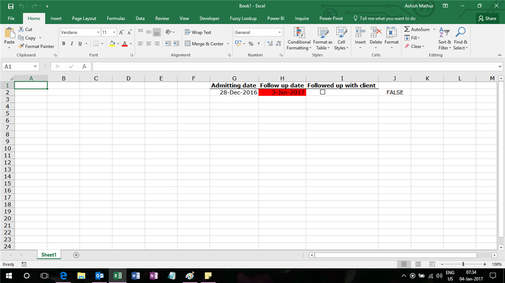

  1. Ashish Mathur 100.9K Reputation points Volunteer Moderator
    2017-01-04T02:05:34+00:00
    Try this
    1. While on cell I2, go to Developer > Controls > Insert > Form Control > Check Box (Form Control)
    2. Draw the check box in cell I2
    3. Right click on the check box and go to Format Control
    4. In the cell Link box, select cell J2
    When you check the box, TRUE will appear in cell J2, else FALSE
    1. Click on cell H2 and write the following formula in the Conditional formatting dialog box
    =AND($H2<TODAY(),$J2=FALSE)
    1. Select the Format of your choice
    2. Click on OK/Apply
    Hope this helps.

    I apologize for the late response, the information that you provided was very helpful. I did include the check boxes and linked them an adjacent cell that gave true or false results, once I did that I used the formula below in the conditional formatting section
    =IF(K5<=TODAY(), AND(M5=FALSE)) then highlight in red .  The only issue I had was having to link each check box to an individual adjacent cell for the entire spreadsheet was a bit time consuming.
