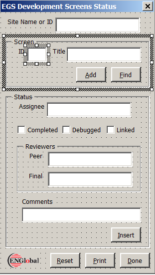

    Thank you very much! Please let me know if you need anything else (the actual file, etc.).
    The Auto_Open macro is:
    Sub Auto_Open()
    Load frmDevScreenStatus <-----this the line it chokes on and results in the error
    frmDevScreenStatus.Show
    End Sub
    Here's the code and a screen shot of the form:
