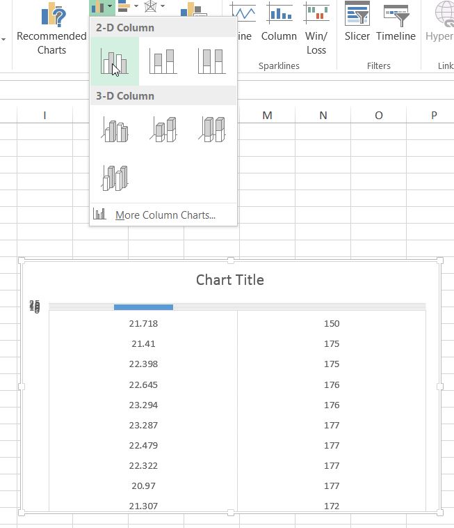

Hello, I want to insert a chart, but when I select data from columns A and C, the chart appears with a data from A & B columns instead. If I select data from columns A & D, then I get column A & C data in the chart. Please advice me on how could I fix it.

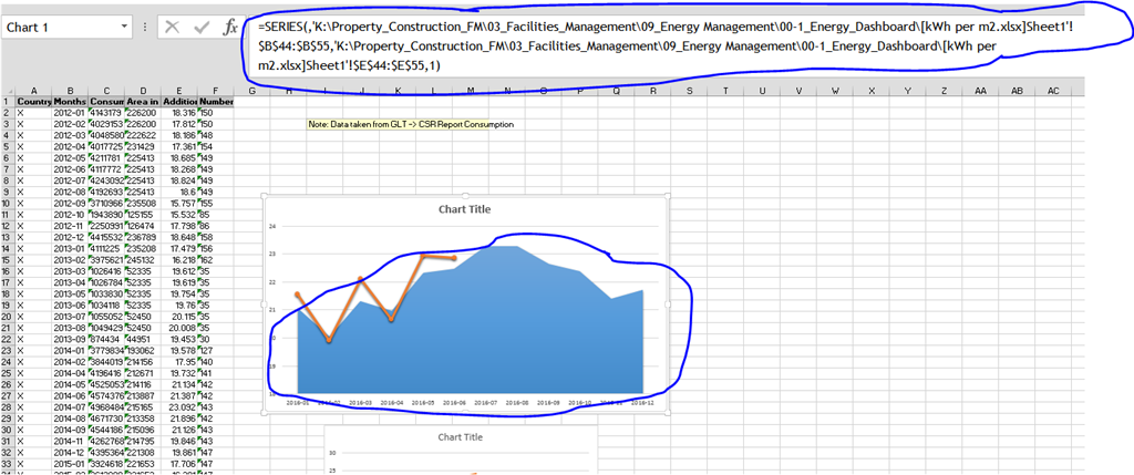

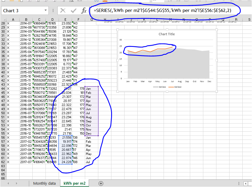

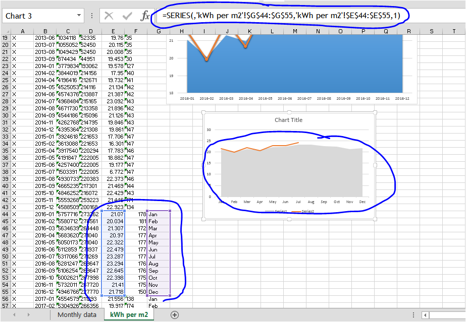

    I opened the file and saw that there are 2 charts displayed.
    The first chart is showing some link to some other file where as the second chart
    shows the data range of the same worksheet and columns E & G.
    I am unable to replicate the problem which you are facing (Columns E & F being selected in the chart).
    Have a look at the screen-shots taken from your file which I downloaded.

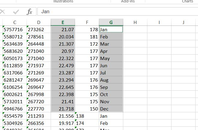

    The problem is only in this sheet, other sheets are not affected. Here I selected columns E and G, but the data in the chart appears from E & F. So if I wanted a correct data from E&G I had to select E&H.
