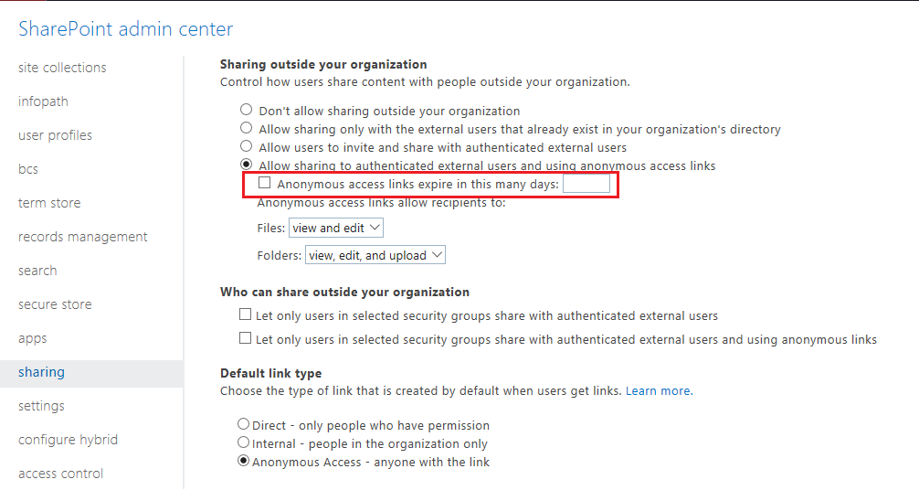

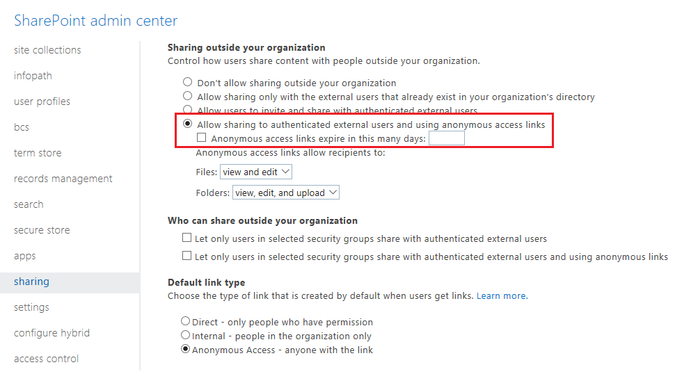

First, regarding the Sharing options, no - only administrators can change the settings. We need to involve your Global Administrator to check the SharePoint Admin Center > Sharing settings and see if anonymous access links are disabled:

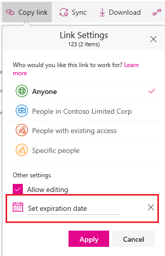

    Hi Melissa,
    When using the Copy Link feature, please check whether there is an expiry date.
    By default it should be empty, but your organization's administrator may have set anonymous links to expire in the SharePoint Admin Center.
    If you are a SharePoint Administrator, you can change this; if you are not, we suggest you contact your administrator to confirm.
    If this is not the scenario you're having, please describe how the links are broken; what are you getting when trying to open the links?

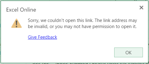

    2018-01-04T19:11:50+00:00
    Here's what I get when I try to follow the link:
    When I copy link, there is no indication of an expiration date--I don't even see the "set expiration date" option in there. I've spoken to the SharePoint administrator and she's not aware of having set any limits to link sharing.
