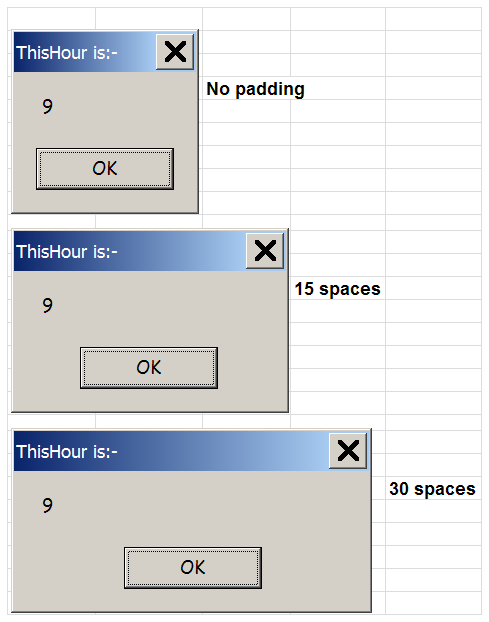

    The Demo sub works for me, as written, and displays the single character "a"
    To enable a wider msgbox in all code in a single project (not all projects), something like the following should work.
    Note that that the constant "MBcaption" is padded with 15 spaces and
    is declared at the top of a standard module (not a worksheet module).
    MBcaption is used for the caption in all  message boxes.
    If you need different text in other message boxes, you can declare additional constants.
    Personally, I just pad the text or the caption with spaces if I want additional width in a msgbox.
    Option Explicit
    Public Const MBcaption As String = "ThisHour is:-               "
    Sub ThisIsWorkingForMe()
    Dim ThisHour As Integer
    ThisHour = 9
    MsgBox ThisHour, vbOKOnly, MBcaption
    End Sub

    Pad the text or caption with spaces.
    Sub Demo()
     MsgBox "a" & VBA.String$(25, 32), vbInformation, "Title"
    End Sub

    Hi Jim, I’ve taken a look at what you’ve said but can’t get it to work.
    This is my existing line of code (which works but puts up the wrong width MsgBox):-
    MsgBox ThisHour, vbOKOnly, "ThisHour is:-"
     - where ThisHour is a Variable of Data Type Integer.
    Sorry; perhaps I should have given you my code in the first place.
    Not only do I want to change the width of the above MsgBox but also the width of any other MsgBox that I may decide to put up.
    Does that make sense?
    Thanks in advance for any replies.

    Jim; for the time being for the purposes for which I'm using the code this:-
    • will have to suffice.
    Many thanks.
