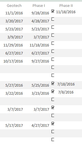

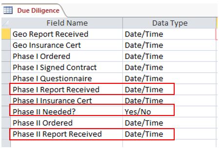

I built an Access Database from scratch, and I’m trying to build a useful report for my team. In the Real Estate world, one report we order is called a “Phase I Report”. If that report comes back clean, no further reports are needed. If contamination is found, a “Phase II Report” must be ordered and completed. I have built in a Yes/No checkbox in the table to mark if a Phase II Report is needed. I’ve inserted a clip of the Due Diligence table that the report is drawing from below:
I built a simple report showing the Phase I Report Received, a check box for if the Phase II Needed? was yes or no, and the Phase II Report Received fields (see below):

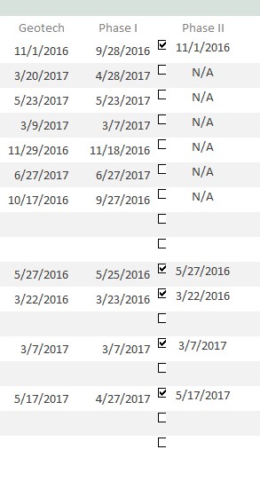

There was some confusion on whether we were still waiting for a Phase II Report, or if it wasn’t required, so I wanted to build an If/Then statement to have the Phase II field state “N/A” if the checkbox was not marked. On the report, I selected the field for Phase II Report Received and tried to change the Control Source to make this work. I used the statement below:
=IIf([Phase II Needed?]=False And Not IsNull([Phase I Report Received]),"N/A",[Phase II Report Received])
It kind of worked, except that the dates it returned for the “False” portion of the equation (should have been [Phase II Report Received]) were identical to the ‘Geotech’ dates. The image below shows the results after I changed the Control Source to an expression. You can see that the dates don’t match the previous image.
How in the world is this happening?? I’ve troubleshooted everything I can think of. Anyone have a better suggestion of how I can accomplish this “N/A” insertion? Or how I can fix this problem? Thank you so much!! It’s driving me insane.
