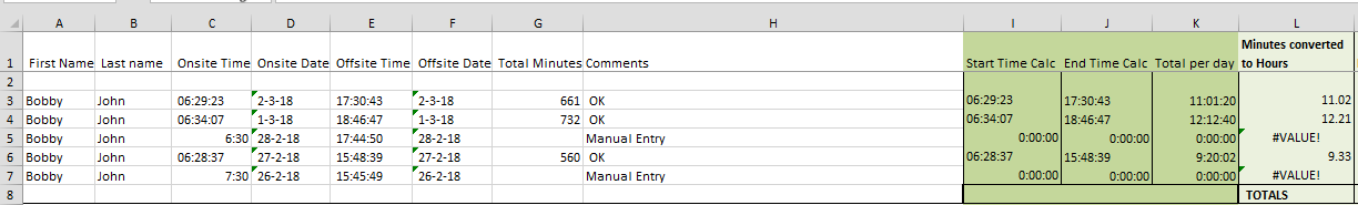

I am trying to make a time sheet as 'untouchable' as possible by using formulas. The business used to use a timesheet software, but they are now using excel as they are required to calculate overtime, weekend hours, food allowance ETC ETC.
Currently, they are having to calculate the time between clocked on an clocked off from an exported timesheet as they require the minute value to turn it into H:MM (i think we can remove the minute step). They have been using a website to do this, and it takes a ridiculous amount of time!
I am having trouble with the cell formatting of the time entries. They come through as hh:mm:ss which i assumed would be perfect, however excel isn't picking up on this format. We have to copy over the time to an excel template of ours with all the other formulas (See below)
The format of the cell is General, and even when i click to change it to Custom > h:mm:ss nothing changes which means my formula  =("end time"-"start time"+("end time"<"start time"))*1440) does not work as it needs the time format.
Now, the simple fix is to just re-write the start or end time. When i do this, it works perfectly, however with so many employees in the one week, i would be adjusting over 100 numbers! (See below when typing in clocked time)
I really have no idea what to do, so suggestions are encouraged and appreciated.
4 answers
    2018-03-05T23:52:31+00:00
    So, i thought had solved the problem. The data was ever changing when it came in. There were 2 ways the time came in, manual input and the input time.
    Manual import worked fine, as excel recognized 6:30 = 6:30:00 AM
    No problems there
    However, when the time came though as it is meant to (e.g. 15:48:39) it wasn't working because.... there was a space in front of it. Easy fix. I just used the RIGHT formula to cut out the space and return the cell to time format.
    So, the formatting is fine... the problem is working with the both of them TOGETHER.
    Here is my current formulas :
    Start time calculation =IF((OR($G3="",G3=0)),0,RIGHT(C3,8))
    End time calculation =IF((OR($G3="",G3=0)),0,RIGHT($E3,8))
    Total per day calculation=IF((OR(I3=0,J3=0)),0,(J3-I3+(J3<I3)))
    Minutes converted to hours =IF((AND(I5<>0,J5=0)),(E5-I5)*24,IF((AND(I5=0,J5<>0)),(J5-C5)*24,IF((AND(I5=0,J5=0)),(E5-C5)*24,K5*24)))
    And the excel below:
    So it is mostly working except when i get a mixture of the 2 formats!!!!!
    I know what i am missing. E5 needs to have a RIGHT formula applied to it, i just don't know how to fit that in! As my logical test for my IF OR formula in column J  (end time) only applies if column G is empty or 0, it means the amount is returned to zero.
    I think getting this RIGHT formula in somewhere is what i need... but i just don't know where to fit it in...
    Any help is really really really appreciated.
    And no macros plz

  3. Vijay A. Verma 104.8K Reputation points Volunteer Moderator
    2018-02-16T05:56:45+00:00
    Do you want to me to correct your dates also? The single macro can take care of both date and time.
  4. Vijay A. Verma 104.8K Reputation points Volunteer Moderator
    2018-02-16T05:50:40+00:00
    There is no other option but to use a macro to convert this as your time have come from website and they do contain other invisible characters.
    What I need a portion of your workbook which has few entries of your time so that I can test the macro.
    Request you to please prepare and upload a sample / dummy file sans confidential / sensitive data to Onedrive and share the link? It will help me to give prompt and high quality solution.
