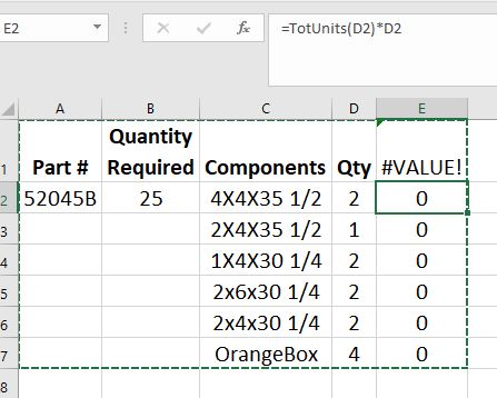

    2018-02-26T14:12:26+00:00
    Good Morning Aussie Mac...I bet you had to think twice about becoming involved "again". I had added the alpha to the table and the programing brought up he components as hoped for. The problem exists when I try to use the Totals for the parts needed....
    Column E is the total boards required and it renders the correct value when the orginal table has just numeric numbers in column A. When I updated the table with "Alpha" then I get the above. Take the "Alpha" out and it works perfect again. That's why it appeared to me that the programing was looking for a "numeric" value only in column A.  As usual I'm grateful for any insight you can share...Thanks.

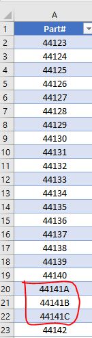

  3. OssieMac 48,001 Reputation points Volunteer Moderator
    2018-02-26T09:00:17+00:00
    It was I who answered your previous question. If you want to add an alpha character to the number then you need to edit the lookup table and add the records with the alpha characters because they become individual values for the Lookup to work..
    eg. if 44141 is now 44141A, 44141B  and 44141C then all the part numbers must be in the lookup table like the following screen shot.
