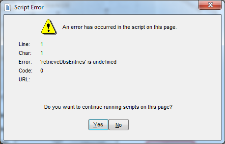

    Here's the error I'm getting:
    'retrieveDbsEntries' is a function in a js file on the local server. I get the same message when trying to run other functions from the same form.

    So you get an error?  What is it?
    Perhaps you need to set the emulsion mode of the browser ActiveX, see http://www.devhut.net/2013/10/18/webbrowser-activex-control-google-maps-invalid-character-scripting-error/

    2017-05-19T02:01:56+00:00
    You could check if anything was installed on that date: Control panel > Programs and Features > Installed Updates, and uninstall it.
    One possibility might be that JavaScript is disabled. Maybe you can think of a way to test that? Perhaps a test page with a simple alert() in it?
    Another possibility might be compatibility level was changed. There is a registry setting for that. See https://blogs.msdn.microsoft.com/patricka/2015/01/12/controlling-webbrowser-control-compatibility/ or several other pages.
