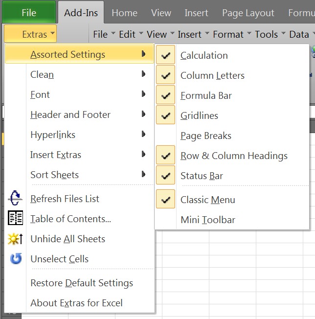

    [Edit - added picture below]
    I created a calc option for my Extras for XL add-in (xl97 thru xl2010)
