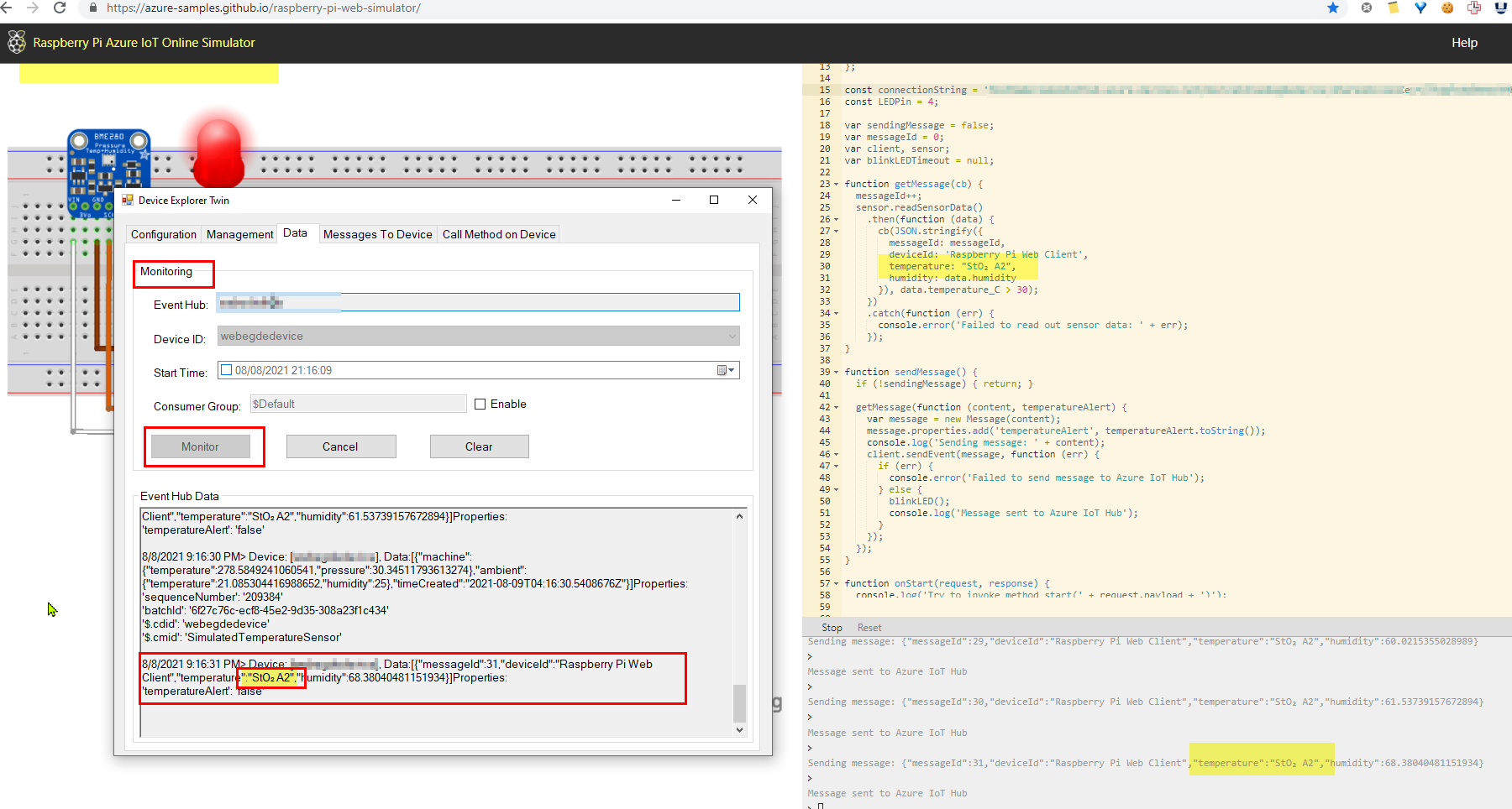

    I have just quickly tested the stage of message sending with special characters like StO₂ A2
    I have used the web-Simulator to quickly send and read the telemetry as shown in the below image.
    https://azure-samples.github.io/raspberry-pi-web-simulator/
    Please comment in the below section for help in this matter, we would be happy to help you.
