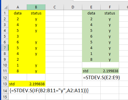

    Your formula looks fine. I suspect you failed to array enter it with Ctrl+Shift+Enter rather then just Enter.
    In the snip below, the yellow is what we wish to do, the green is there to show the array formula does work
    Type =STDEV.S(IF(B2:B11="y",A2:A11)) then press Ctrl+Shift+Enter ; Excels will add the curly braces (you must not type them)
