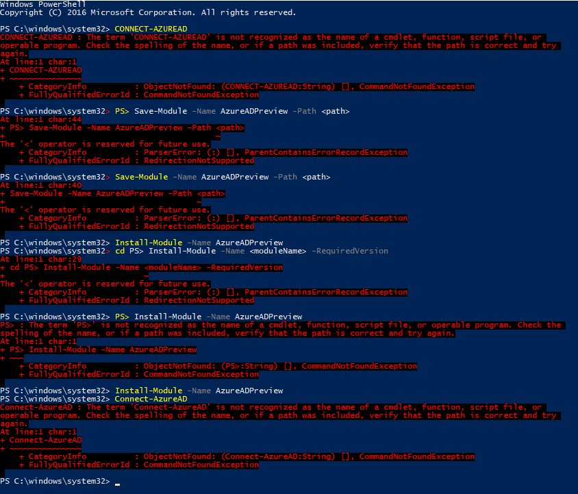

I am following the steps in this article: Restore a deleted Office 365 Group.
I have finished the steps under "Install the preview version of the Azure Active Directory Module for Windows PowerShell", but when I try to run this command "Connect-AzureAD", it does not prompt me to sign in. instead, it returns an error stating that the term cannot be found, please see the picture below:
any help is appreciated.

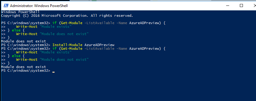

    Hi Arya_2017,
    I tested on my lab and I can login to Azure AD.
    Please run the scripts in PowerShell which is used to check if the AzureADPreview module is installed or not:
    if (Get-Module -ListAvailable -Name AzureADPreview) {
    Write-Host "Module exists"
    } else {
    Write-Host "Module does not exist"
    Please note that you need to run the PowerShell as an administrator.

    2017-08-10T05:09:13+00:00
    thanks Brook.
    I run the script you provide, it returns "Module does not exist".
    I try to install the module using the script: Install-Module AzureADPreview, then use the script to check the result, the same error.
    it seems I cannot install the AzureADPreview module, how to fix this?

    Hi Arya,
    Please also try to run Windows PowerShell, Windows PowerShell ISE, Windows PowerShell ISE (x86) as an Administrator to see if you can install the Azure AD module.
    Thanks,
    Brook
