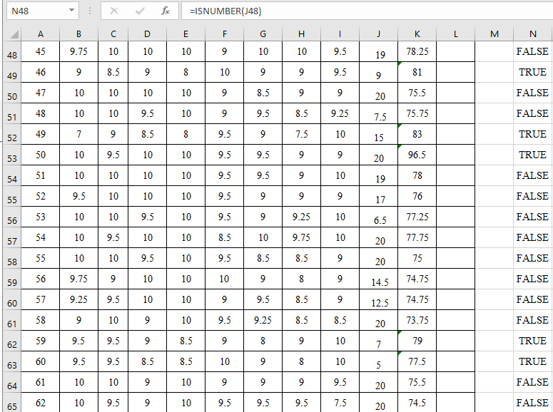

The problem is that many of the entries in J (from row 48 down) are not numbers but text.
Example J48 looks like 19 but is actually (space)19
See screenshot

    2017-05-07T04:36:39+00:00
    Dear Sushant Chopdekar,
    In future, in addition to the methods which Bernard Liengme has suggested, use the following formulas on the ranges which you calculate.
    =COUNTA(A1:A10)  will count numbers and text
    =COUNT(A1:A10) will count number.
    Totals should be equal
    You could also use
    =COUNTA(A1:A10)-COUNT(A1:A10)
    Result should be zero
    Change the cell ranges as required.
