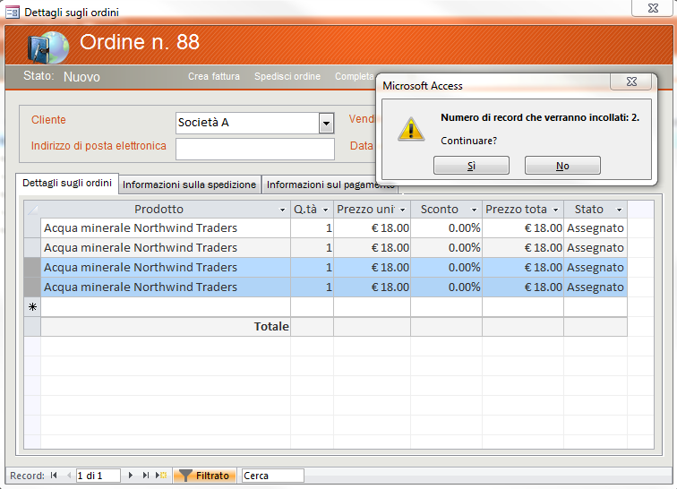

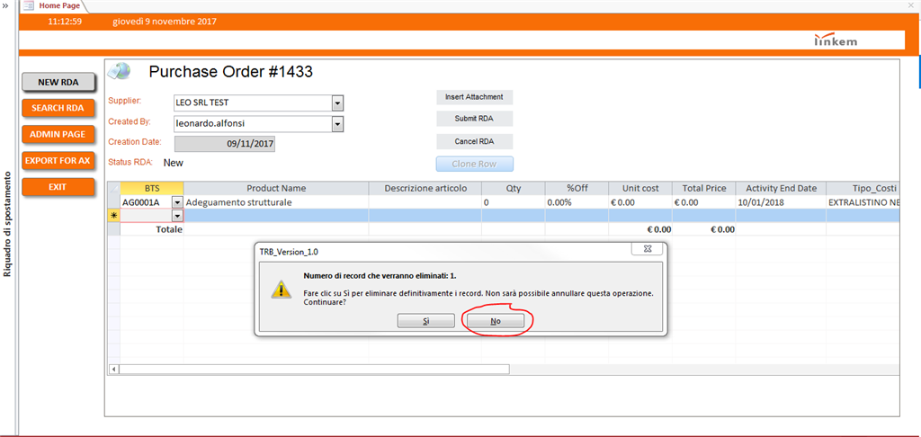

First of all sorry for my poor english. I'm a beginner in vba/sql programming and I have developed an application in access following Northwind database as example. The application works perfectly but how you can see from the image below when I try to copy and paste the entire row (CTRL+C then CTRL+V) into an empty record of the table, access always requests me to manage the following selection and always I have to select NO.
How can I manage this exception in order to select always NO automatically and avoid the comparison of this pop up window?
I know the DoCmd.SetWarnings = False method but I don't think it is the best solution for my issue.
Do you know some libraries in access, suitable for handle exceptions or pop up like this via vba code?
nB: inside the pop up window is written: Number of record will be deleted: 1 - Clic on "SI" to delete these records....Do you want to continue?

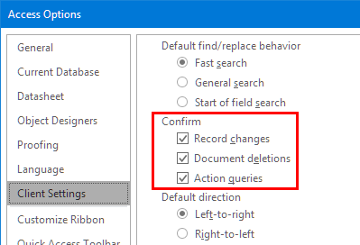

    P.S. There are settings in File > Options > Client Settings for this:
    But these are user-level settings, not database-level settings. You shouldn't change those settings in your code.

    Hi Hans thank you for your answer. Unfortunately DoCmd.SetWarnings method select always "SI = YES" option so the application maybe try to delete the empty row of the form generating me an error.
    I cannot understand why in Northwind traders example when I add one or more record in the window below the app doesn't ask to delete rows, it just add the new ones without warning messages on the top of the empty row. I have copied the main functions
    Probably I need to study more and find the differences between my app and Northwind
    Don't worry for your italian I'm bad at english so we are balanced...However I think it's a good training for us :)...However if you have Northwind example in english, you can easily find the window I refer to and i have used as template for my application (see the image below)

    Hi Tom thanks for your reply. I have used the following window of Northwind example to build my application (sorry I have the only italian example)...However when I enter a new row manually the app works normally and it doesn't ask any message like Northwind.
    I think when I click 'Yes', the row that the app try to delete, is the last empty row.
