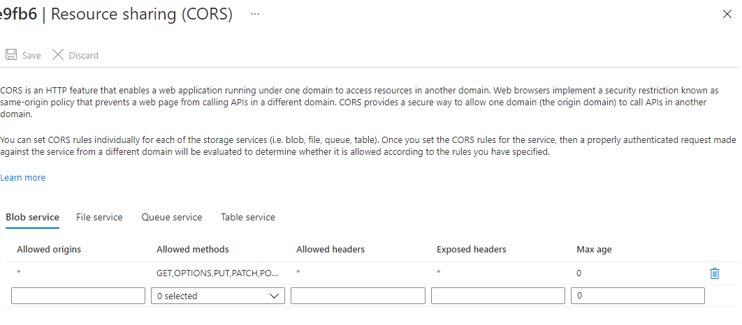

I'm using a url shortner (custom hosted yourls) to redirect to a html page on azure blob storage. It works on a browser but when I do a GET without headers (I need this), it gives me an error.
I have set on CORS on azure storage to allow everything already
I tested with test-cors.org and it gives me
Sending GET request to https://yourls.com/testurl
Fired XHR event: loadstart
Fired XHR event: readystatechange
Fired XHR event: error

    Given that it works with tinyurl and not your custom service I would focus on what is difference between these two services. When i test with test-cors and tinyurl I can see a cors http header in the response: access-control-allow-origin: http://test-cors.org. Your storage account config looks as permissive as it can get and if that tests okay from test-cors when you use the storage url directly i would be looking elsewhere.
