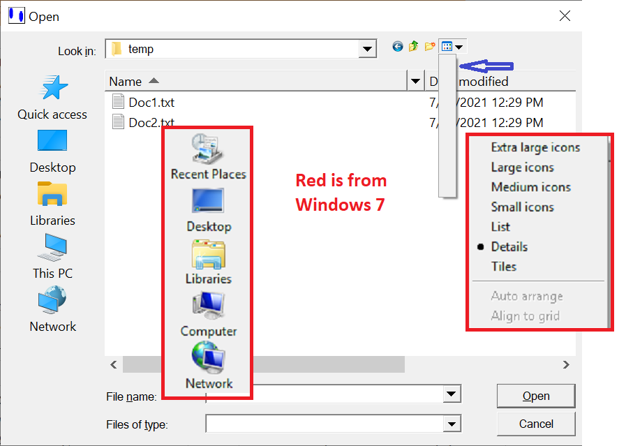

The C++/MFC File Open dialog (CFileDialog) produces incorrect results on Windows 10. Namely, the View Menu dropdown (blud arrow) is empty. The same executable, run on Windows 7, produces the expected View Menu (red box). Another difference is the navigation pane on the left. The navigation pane difference is unimportant; I just showed it for completeness.
The C++ code producing this image is CFileDialog dlg(TRUE); dlg.DoModal();

For large project, using the debugger to step thru the CFileDialog constructor shows that the call to CoCreateInstance returns CLASS_E_CLASSNOTAVAILABLE ClassFactory cannot supply requested class. In the new test project, this function does not return an error.
