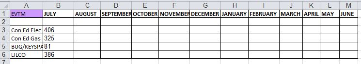

  • i want to link data between two Sheets based on the month(Jul - Jun). Sheet 1 and Sheet 2.
Sheet 1 contains the final result
Sheet 2 contains the raw data.
On sheet1, cell B3:B6. I have this formula:
B3 =IF(LEFT(MONTH('sheet2'!D23),2)="7",'sheet2'!E33, "")
B4  =IF(LEFT(MONTH('sheet2'!D23),2)="7",'sheet2'!E35, "")
B5  =IF(LEFT(MONTH('sheet2'!D23),2)="7",'sheet2'!E38, "")
B6  =IF(LEFT(MONTH('sheet2'!D23),2)="7",'sheet2'!E40, "")
How do I prevent the values entered in July from Changing when I enter the new value for August?
Is there a better and cleaner method to do this because I will need to link all the cells with  the above formula from July to June?
If there is a  better way, how do I do it?
Thanks!!!!

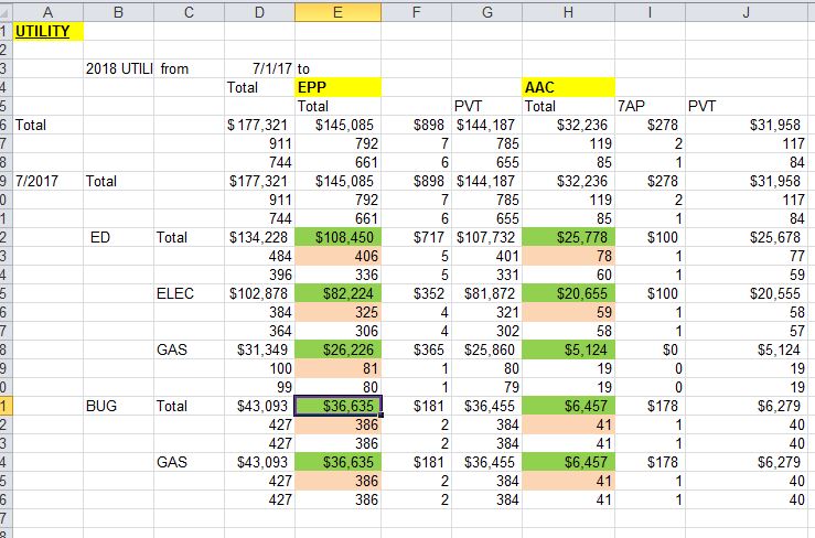

    2017-08-17T12:52:52+00:00
    This is the raw data in sheet2 that i have to populate in sheet1. the section in green and orange. I only showed the data in orange on sheet1.
    The green will be the same process once i figure out the orange.
    Thanks!!!
