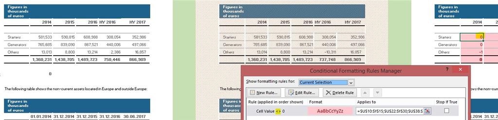

Hi everybody,
as you can see on the screenshot attached, the conditional formatting should not apply to the cell highlighted as it is zero (and others). However it is applied in the conditional formatting.
What might be a reason for that?
I will appreciate your help!
Thank you!
Best wishes,
Exceliser_123

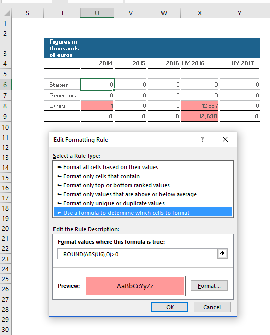

    2017-10-23T15:40:19+00:00
    The values in the cells U6:Y9 are obtained from formula; the cells have been formatted to display integer values but the stored vales and not zero (see the first snip where the cells have been formatted with 4 decimals).
    I have used the formula in the Conditional Formatting dialog to get the required result:
    =ROUND(ABS(U6),0)>0
    See the second snip
    best wishes
