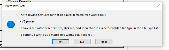

Hi
I have the following macro that "Save As" from a normal Macro Enabled Workbook. The problem is that when I use from a Macro Enabled Template Workbook the below Macro does not work, an error always comes up where the bold part is within the below macro
Thanks & Regards
Owen Burman
Sub savefile()
Dim sFile As String
Dim name As String
sFile = Range("N4")
name = Application.GetSaveAsFilename(sFile, "Excel Macro-Enabled workbook(*.xlsm),*xlsm")
If name = "false" Then
Exit Sub
End If
ActiveWorkbook.saveas (name)
ActiveWorkbook.Close
End Sub
  1. Andreas Killer 144K Reputation points Volunteer Moderator
    2017-09-08T07:15:54+00:00
    The problem is that your default file format in Excel is XLSX and a SaveAs with no given file format uses that. Please read the help to SaveAs in VBA for details on the file format argument.
    So if you create a new file from this template you have a VBProject, which can not be saved in a XLSX file, hence the error.
    If you want to suppress this error execute
      Application.DisplayAlerts = False
    before you save the file as XLSX
    Otherwise use
      ActiveWorkbook.SaveAs name, xlOpenXMLWorkbookMacroEnabled
    BTW, "Name" also a VBA method, I recommend to use
      Dim FName As String
    instead.
    Andreas.
    2017-09-08T02:53:46+00:00
    The pop-up which you are showing here gives a bit of a surprise!
    Ideally this error message pop-up appears when an excel file containing a macro is NOT saved as a macro file ( I mean .xlsm ). I doubt you might have not done this.
    However, pls have a double check if by any chance the file has been saved as a .xlsx
    (by the way - what excel version are you using?)
    Secondly, as far as your run-time error is concerned, Pls check if you are giving a complete file name (inclusive of folder path and the file name) while using saveas.
    I follow the following practice in all my Excel macros:
    OutFileNm = "Sales Master FY201718"                        ------ a file name without extension
    OutFileNmwe = OutFileNm & ".xlsx"                           ------ patch file extension
    OutFilePath = "D:\folderlevel1\folderlevel2\folderlevel3"     --------- complete folder path
    OutFullFileName = OutFilePath & "" & OutFileNmwe    ------ Full file name (with path) for file opening,
                                                                                                        saving, closing, etc.
    Hope this Helps.

    2017-09-07T13:45:48+00:00
    What is the error that you are getting ?
    2017-09-07T14:09:19+00:00
    Hi
    First the above pop-ups appears then the following error appears as well.
    "Run-Time Error 1004"
    "Application Defined Or Object Defined Error"
    Thanks & Regards
    Owen
