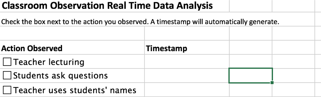

My goal is to create an automatic timestamp in column B when you check a checkbox I have inserted into column A. The timestamp in column B would be adjacent to the checkbox checked in Column A. See a screenshot of my spreadsheet set up below:

    That mostly worked, with a slight glitch. The date appeared, but not in the adjacent cell. It posted in the adjacent cell in the row above (for teacher lecturing, it posted over the 'timestamp' label). Do you know how I can fix that? Is it something in the code?

    2018-01-06T21:29:22+00:00
    I don't understand the slight glitch.
    This line of code     With cbx.TopLeftCell.Offset(0, 1)
    chooses the adjacent cell to the right of the CheckBox cell
    Offset(0,1)    means 0 rows up or down and 1 column to the right.
