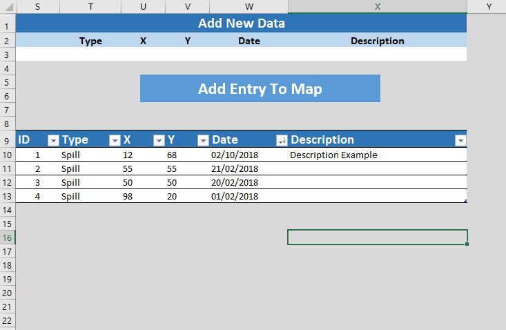

I'm trying to make a sheet where I can input some data, press a button and that data gets added to the table below it.
I've tried recording a macro but it doesn't seem to work, so I'm thinking I need some VBA code. Every row of the table also has to have a unique ID number and the whole table needs to be sorted newest to oldest. For the ID number I'm currently using =ROW(S1), =ROW(S2) etc.

    I'd use the following formula in S10:
    =ROW(S10)-ROW($S$9)
    This will remain valid even if you move the table up or down.
    Assuming that your table is the first or only table on the sheet:
    Sub AddRow()
        With ActiveSheet.ListObjects(1).ListRows.Add.Range
            .Offset(, 1).Resize(, .Columns.Count - 1).Value = Range("T3:X3").Value
        End With
    End Sub

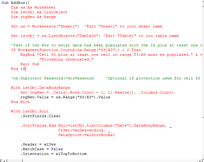

    2018-02-21T09:16:39+00:00
    Hi, Thanks for such a detailed response!
    Not sure if I'm just being stupid but when I paste the code in I just see a lot of red and get Syntax Error.
    I am not aware of that occurring before so I am not sure exactly what is causing it. I just copied the code from the forum post into a blank workbook and it copies and pastes fine.
    Did you copy the code from the forum post or from the email notification? If you copied from the email notification, then go to the forum post and copy from there.
    If that does not work then I am wondering if there are some spurious characters already in the Module. Insert a new module into your workbook and then try copying and pasting the code into the new module and see what occurs.
    The other thing that could occur is that for some reason there are spurious characters on the end of the line. Try positioning the cursor at the end of each of the lines and press the delete key and see if you can delete them. If you delete too many and the following line comes up to the end of the line you are on then just press Enter to move it back onto the line below.
