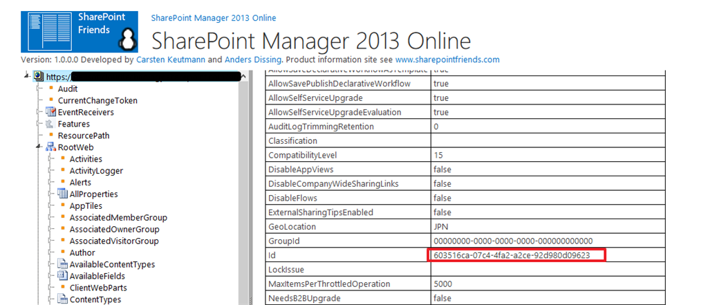

So I think my thought is right the change is effective on my site collcetion. The scope ID:3385278E-DF2F-484E-9FA6-E1CF89D5AF1F should be the sitecollection ID,because I grantted the user permission in site collection level.
But I found that the Scope's ID isn't equal  to the real site collcetion ID. And I think I have found everywhere in the site colleciton to found the Scope's ID by 【SharePoint Manager 2013 Online】but I didnot found the scope ID: 3385278E-DF2F-484E-9FA6-E1CF89D5AF1F 's location.
※The real site collection's ID is in above which is 603516ca.............
So I want to know where is the scope id. And what is the <scope>'s real meaning.

Hi Tobey2017,
Scope in the audit log does not refer to the site collection ID. Instead, it refers to the SP permission.
For the detailed information, you can refer to the article below,
especially the SharePoint permissions scope system overview part:
Fine-grained permission reference for SharePoint Server 2013.
