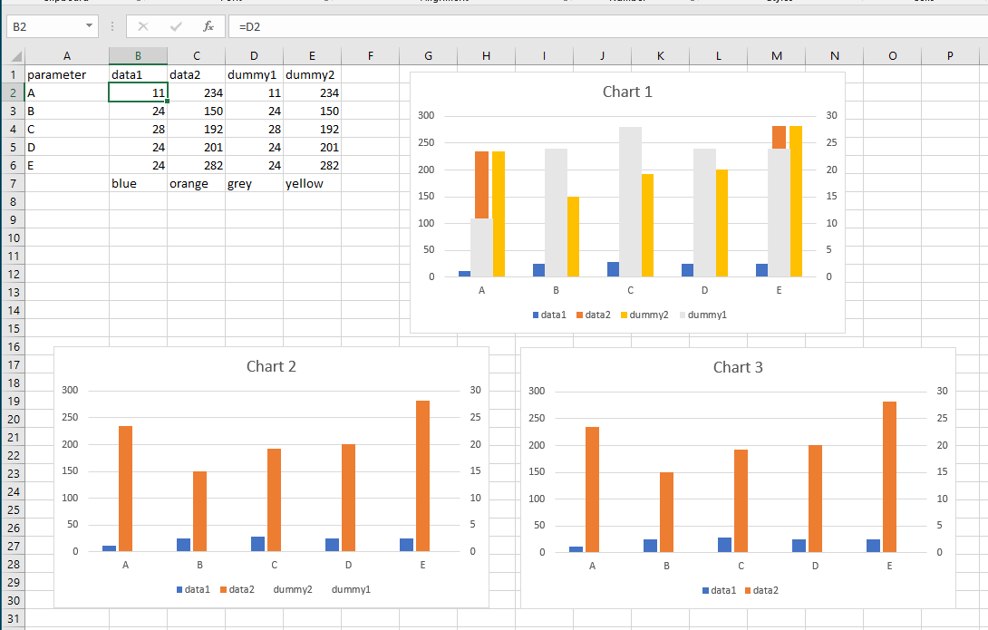

    Here is a work around.
    Looking at my snip: I started with three columns A, B C with the data to be charted
    I inserted a new B and C column; in B2 entered =D2 , in C2= E2 and copied the formulas down the columns. Note the odd column titles!
    Made a cluster chart of the three data series
    Formatted the dummy1 data series to use a secondary axis - Chart 1
    Formatted the dummy1 data and the dummy2 data to have no fill and no border data columns to have no fill and no border - Chart 2
    Deleted the dummy1 and dummy2 legends at the bottom - Chart 3
    Note that the real data is in the two dummy columns
    Some formatting might help hide the big gaps between the categories

    Thank you, Bernard. I used a similar work-around with dummy columns of data and then deleting the labels for them. I will have to work on the formatting some. I appreciate you stopping by and offering this solution.
