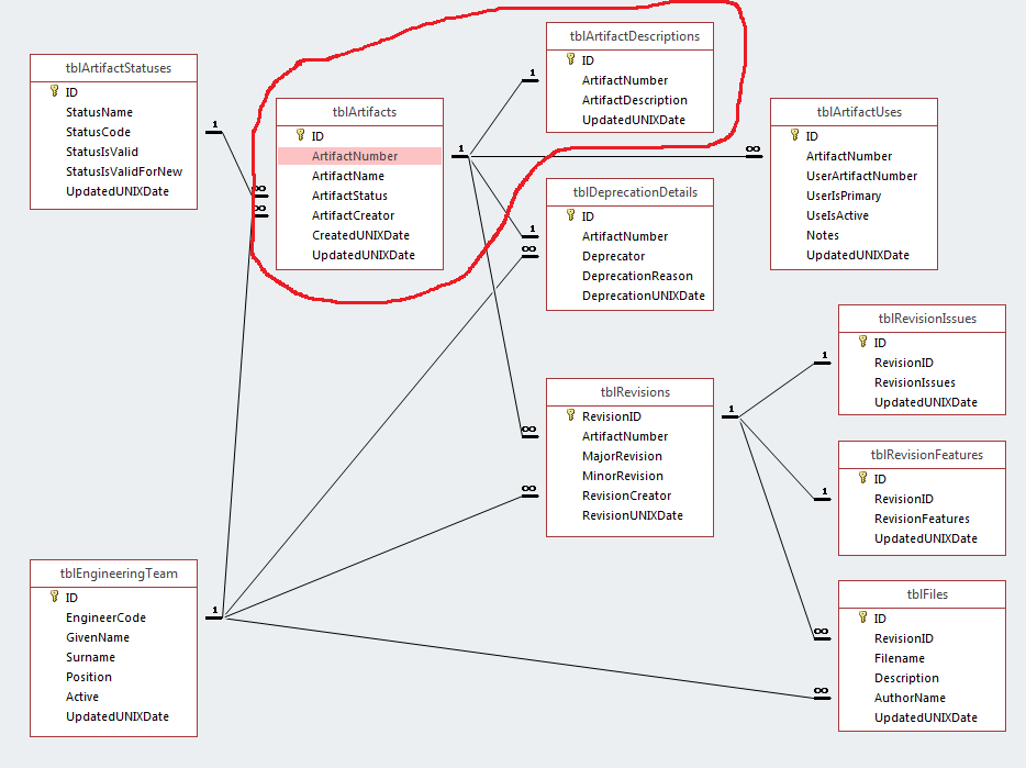

Hello, all. I am in the process of setting up a database for work to keep track of engineering components that my group designs. I am very new to access and I am getting stuck on what I feel must be very basic problems (I'm very comfortable programming in a variety of languages, but Access is just breaking by brain!)
I have a main table - tblArtifacts - that contains information about the things that we design (we generically refer to each one as an "artifact"). Each artifact has unique number, a name, a status, a creator, etc. I have another table - tblArtifactDescriptions
  • that has a one-to-one relationship with tblArtifacts. Each record in tblArtifactDescriptions contains a long text field for a detailed description of each artifact in tblArtifacts*. The records in tblArtifactDescriptions also a field for the unique artifact number that was used in tblArtifacts.
The problem is pretty simple: I want a single form for adding artifacts to my database, but this one form needs to add a record to both tblArtifacts and tblArtifactDescriptions, both of which need to use the same ArtifactNumber (not surprisingly I use ArtifactNumber as the foreign key in tblArtifactDescriptions). How do I get Access to do this? Is there a way that I can do this without resorting to VBA? I've included the table relationships output for my database with the two tables I am talking about here circled in red to make it clearer what I am talking about.

  1. Duane Hookom 26,575 Reputation points Volunteer Moderator
    2018-01-30T18:38:22+00:00
    I think part of the issue is that all of the artifact child tables should be linked to the ID field of tblArtifacts not on ArtifactNumber.
    In addition, I believe you are working to hard. Simply create a subform based on the tblArtifactDescriptions and drop it on the main form for tblArtifacts. You would set the Link Master/Child properties of the subform control to the Primary and Foreign key fields. There is no coding required. If you have the relationships set correctly as you add a record to the subform, it will automatically inherit the primary key value from its parent form.
    2018-01-30T19:22:28+00:00
    Having the ArtifactNumber as the primary key should resolve the issues I had with your structure.

    2018-01-30T19:10:12+00:00
    Thanks for the reply, dhookom,I'll give what you suggest a try.
    WRT the ID field vs ArtifactNumber field, I have only included the default ID field because I was advised to keep it even if I don't need it. I need control over the ArtifactNumber, so I didn't want to use an Auto number field. I have ArtifactNumber set to "Indexed (No Duplicates)", so I suppose I could just eliminate the ID fields from tables where I am using ArtifactNumber as the defacto primary key (tblArtifacts, tblArtifactDescriptions, & tblDeprecationDetails). Is there any reason to keep the ID fields those tables?
