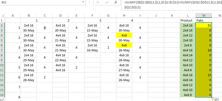

    Refer below image, use the formula in M2 cell and copy down:
    =SUMIF($B$2:$B$13,$L2,$C$2:$C$13)+SUMIF($D$2:$D$13,$L2,$E$2:$E$13)+SUMIF($F$2:$F$13,$L2,$G$2:$G$13)+SUMIF($H$2:$H$13,$L2,$I$2:$I$13)
    One thing, in H4 cell and H6 cell not appeared the complete product name like so the sum not returned properly for "4x6 16". This should be 23 but as per data it returned 15.

    Each column will have the product example 2x4 16, 4x4 16, etc.. the cell below will be the date, the cell to the right will have how many packs are in the group... so in cell 1-1 underlined in below picture, you have 2x4 16, date 5/30, and 4 packs. what i am needing and i was trying to achieve with sumifs. I am needing it to add all the packs for each criterion.
    so the answer should be 2x4 16s = 31
    4x4 16s =18
    4x6 16s = 23
    The blank cells need to be in the formula too due to they at some point will all have data in them with different products.

    So below is where the number of packs should be added so i am trying to find a formula that will look at all the cells if 2x4 16 then add the number of packs in the 2x4 16.

    Hi, with the reference of below image:
    Use the formula in D1 cell and copy down:
    =CONCATENATE(LEFT($A1,6)," = ",IF(LEFT(A1,3)="2x4","5p","8p"))
