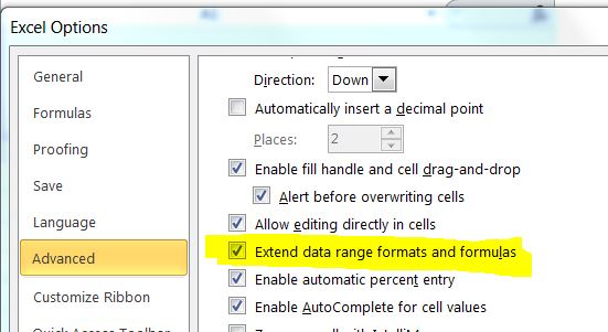

    2017-06-12T20:13:28+00:00
    Try changing this setting (to checked) or convert your range to a table using Insert / Table
    2017-06-12T19:15:22+00:00
    Thanks very much, it's working very well now.
    One more thing. as i was editing yesterday, at some point the A through L Columns (Which are filled with formulas) started following/dublicating the cell's as i was typing the "random" number in the G column. How did i get them to do this.
    After rewriting the formulas, it has stopped doing it, but i really need it to do it.?
