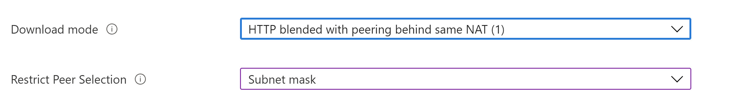

  1. Jason Sandys 31,421 Reputation points Microsoft Employee Moderator
    2021-07-30T17:38:13.623+00:00
    The option is for grouping systems which can be done in multiple different ways. Without this grouping DO does not have a way to determine which peers should share content with each other. Instead of grouping, you can also restrict DO to subnets -- this potentially limits the effectiveness of DO at locations with more than one subnet though.
  2. Jason Sandys 31,421 Reputation points Microsoft Employee Moderator
    2021-07-30T18:19:26.913+00:00

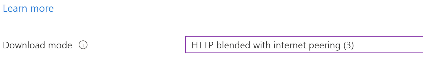

    Grouping or DO subnets can be done through DO Policy in Intune right? so in this case we don't need to create a GPO with DHCP option, do we?
    Correct.
    what do you recommended from below three option?
    Whatever works for you. We have multiple options as there isn't a one size fits all answer here.
    Technically can I used any of below three option?
    Yes. For your Option 1 above though, you should select a group ID source though as that mode (2) specifically is for using groups so not having a group source may not be valid.
    I would never use mode 3 though in anything but a trivial environment.
