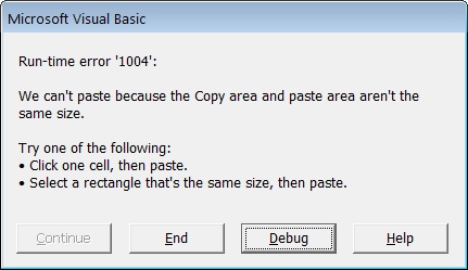

I have 4002 rows and 5257 columns i.e. A1 to GTE4002. I have written a macro to swap rows and columns, create a new sheet and paste.
Dim ws1 As Worksheet
Sheets("MainSheet").Activate
Sheets("MainSheet").Cells.Select
'Range("A1:GTE4002").Select
Selection.Copy
Set ws1 = Sheets.Add(After:=ActiveSheet)
Selection.PasteSpecial Paste:=xlPasteAll, Operation:=xlNone, SkipBlanks:= _
False, Transpose:=True
Sheets(ws1).Select
Sheets(ws1).Name = "SHEET1"
I got a runtime error as shown in the fig. Is there anyway to debug this error?

You commented out the line to select A1:GTE4002, so your code operates on Cells, which consists of 1048576 rows and 16384 columns. This range cannot be transposed since there is no room for 1048576 columns.
Here is a version that copies only A1:GTE4002:
Sub CopyMainSheet()
    ws1.Name = "SHEET1"
    Sheets("MainSheet").Range("A1:GTE4002").Copy
    ws1.Range("A1").PasteSpecial Transpose:=True
End Sub
Or if you want to copy/paste the used range of MainSheet:
Sub CopyMainSheet()
    ws1.Name = "SHEET1"
    Sheets("MainSheet").UsedRange.Copy
End Sub

    Thanks. It worked :)
