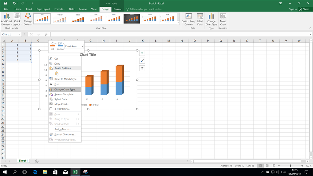

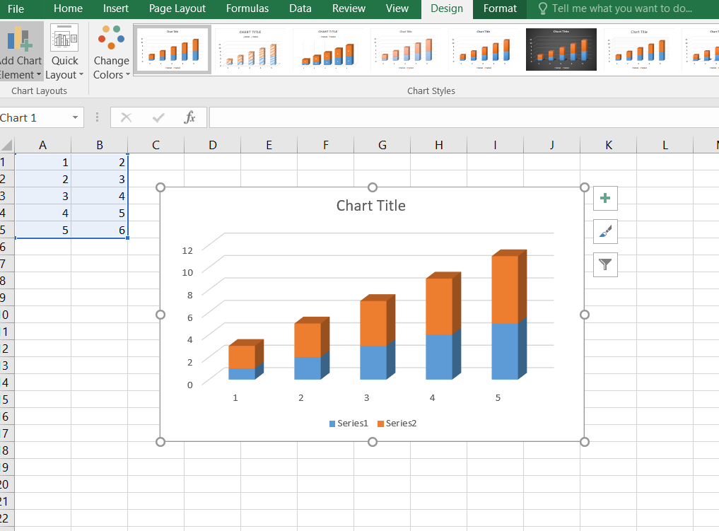

Hello,
My problem started on August 13 after windows/office update.

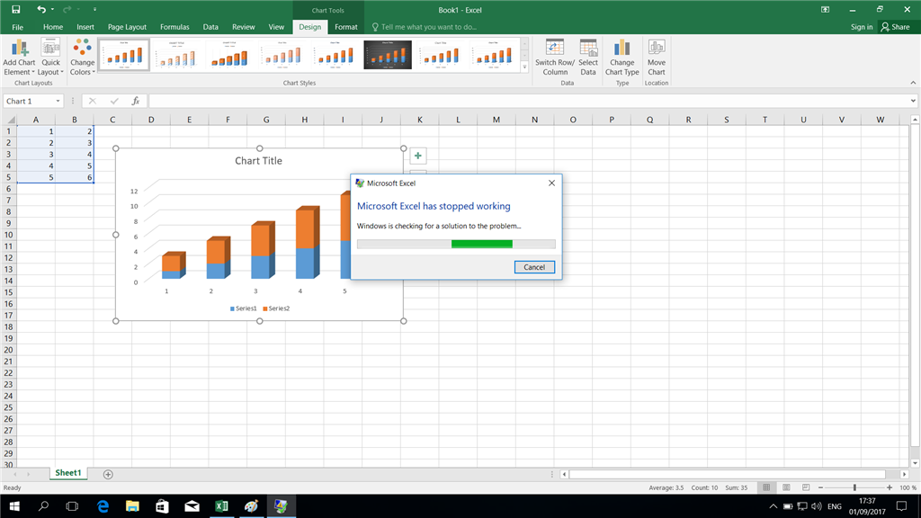

I create new workbook with default template, (I tried also with different templates), I insert data, create a chart, then right-click, "change chart type", Excel crashes. Sometimes the dialog appear with missing buttons of "Okay" and "Cancel", then crashes after the changing.

The crash is consistent, reproducible and fatal!
Faulting application name: EXCEL.EXE, version: 16.0.4561.1000, time stamp: 0x5940b0f2
Faulting module name: chart.dll, version: 16.0.4534.1000, time stamp: 0x58ecdf28
Exception code: 0xc0000005
Fault offset: 0x0000000000010160
Faulting process id: 0xb10
Faulting application start time: 0x01d32313c3ceca27
Faulting application path: C:\Program Files\Microsoft Office\Office16\EXCEL.EXE
Faulting module path: C:\Program Files\Microsoft Office\Office16\chart.dll
Report Id: 3d45f9b3-b293-4195-8595-5709dadb58ce
Faulting package full name:
Faulting package-relative application ID:
