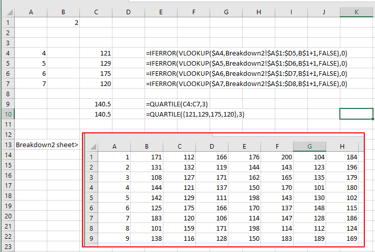

    2017-10-30T17:19:04+00:00
    You formula should result in =QUARTILE({1,2,3,4},3) not =QUARTILE((1,2,3,4),3)
    But I was unable to get Excel to accept this
    =QUARTILE({VLOOKUP($A4,Breakdown2!$A$1:$D$6,B$1+1,FALSE) ,VLOOKUP($A4,Breakdown2!$A$1:$D$6,B$1+1,FALSE) ,VLOOKUP($A4,Breakdown2!$A$1:$D$6,B$1+1,FALSE) ,VLOOKUP($A4,Breakdown2!$A$1:$D$6,B$1+1,FALSE)},3)
    I can get an answer using four cells for the values - see snip
    best wishes
