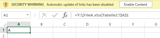

    • Open FileB.xlsx manually
    You should see a message at the top:
    If you click "Enable Content" the formula updates and the cell shows "XX".

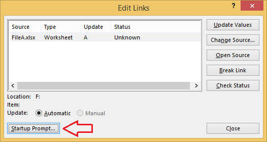

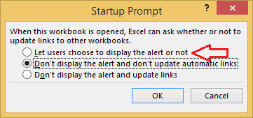

    If you don't see that message, go into the Data tab, click "Edit Links", click the "Startup Prompt..."
    The usual setting is the 1st one, but you might have the second as this picture shows:

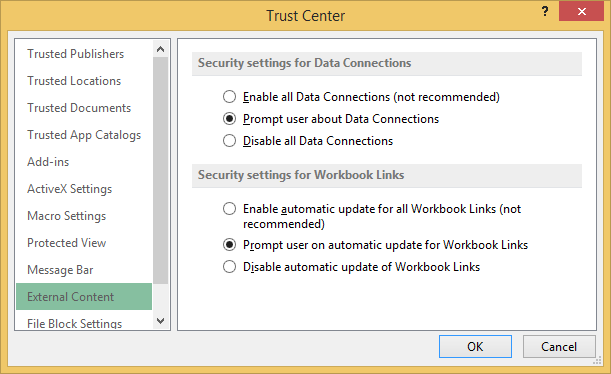

    Check also the settings inside the Trust Center\External Content:
