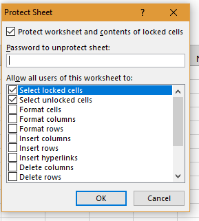

    2017-05-16T19:17:03+00:00
    You can protect the worksheet by click Home Tab - Format - Protect sheet. See the snip below
    What you do is apply a check mark against all things you want then to be able to do so leave add/delete rows and columns un-checked. You can also add a password.

    2017-05-17T13:35:20+00:00
    It does work. See the snip below click the symbol above the 1 to select all cells then right click any cell and click 'Format cells' and on the protection tab remove the checkmark from the 'Locked' box.
    Now follow the instructions in my previous post and check everything in the popup except insert rows/columns and delete rows/columns
