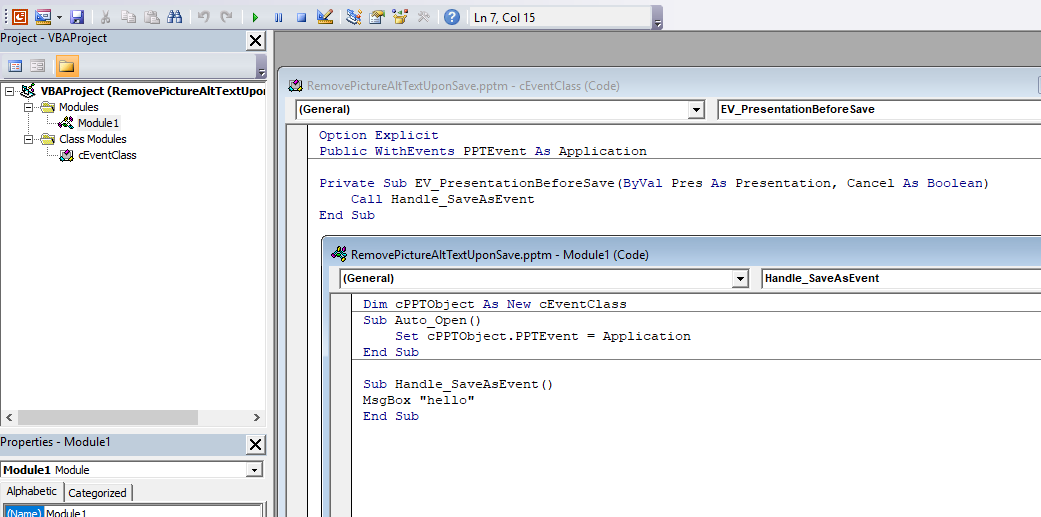

    @John SR Wilson, thanks. I was using whatever Steve recommended I use. However, I have just tried your suggestion, which now looks like this
    I trust I have everything in the right place?
    When I save this as a *.ppam and load as an add-in, I don't get any message boxes when saving or saving as. Before, using Steve's code, I got a "hello" prompt after saving, but only when selecting pptx as the file format. The "hello" never appeared if I changed the file format to PDF then pressed save.
    Hope this makes sense.

    Did you use the Save event or the BeforeSave event? the latter might be what you need.
    Private Sub EV_PresentationBeforeSave(ByVal Pres As Presentation, Cancel As Boolean)
    Call killAlttext(Pres)
    End Sub
