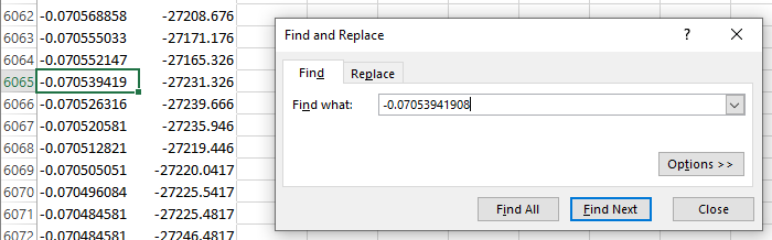

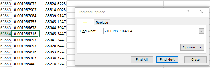

    I type the last display data of both issue related pivot tables in the Find window and I got the following result:
    BAD_RowLabelsTruncatedInGraph stoped in 63664:
    BAD_RowLabelsTruncatedInGraph2 stoped in 6065:

    The second pivot "BadRowLabelsTruncatedInGraph", has approximately 130,000 row labels, but you'll see the result stops at (~80,000). It's only displaying the first 30,000 labels.
    The third pivot "BadRowLabelsTruncatedInGraph2", again has approximately 137,000 row labels, but it only shows the first 6000 labels.
