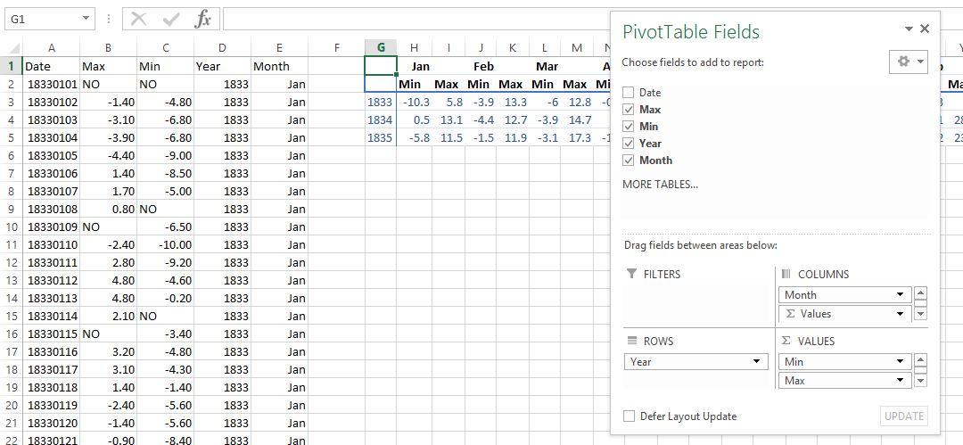

An other way is to use helper columns to pretend a date and a Pivot Table.
D2: =VALUE(LEFT(A2,4))
E2: =DATE(0,VALUE(MID(A2,5,2)),1)
Column E is formatted as MMM
The Pivot table shows the totals (min/max for each year) at the right.
Andreas.

    2018-08-19T18:47:26+00:00
    Hi Andreas Killer,
    In a word, as in a hundred: thank you.
    The VBA module achieves exactly what I wanted. I admit that the problem was more complex than I imagined. I wouldn't have been able to solve it myself. I had been thinking about the pivot-table. But I had rejected this solution because of the dates lower than 01/01/1900. In this case, you also propose a simple but ingenious solution.
    Bravo and thank you again.
    GiHem
