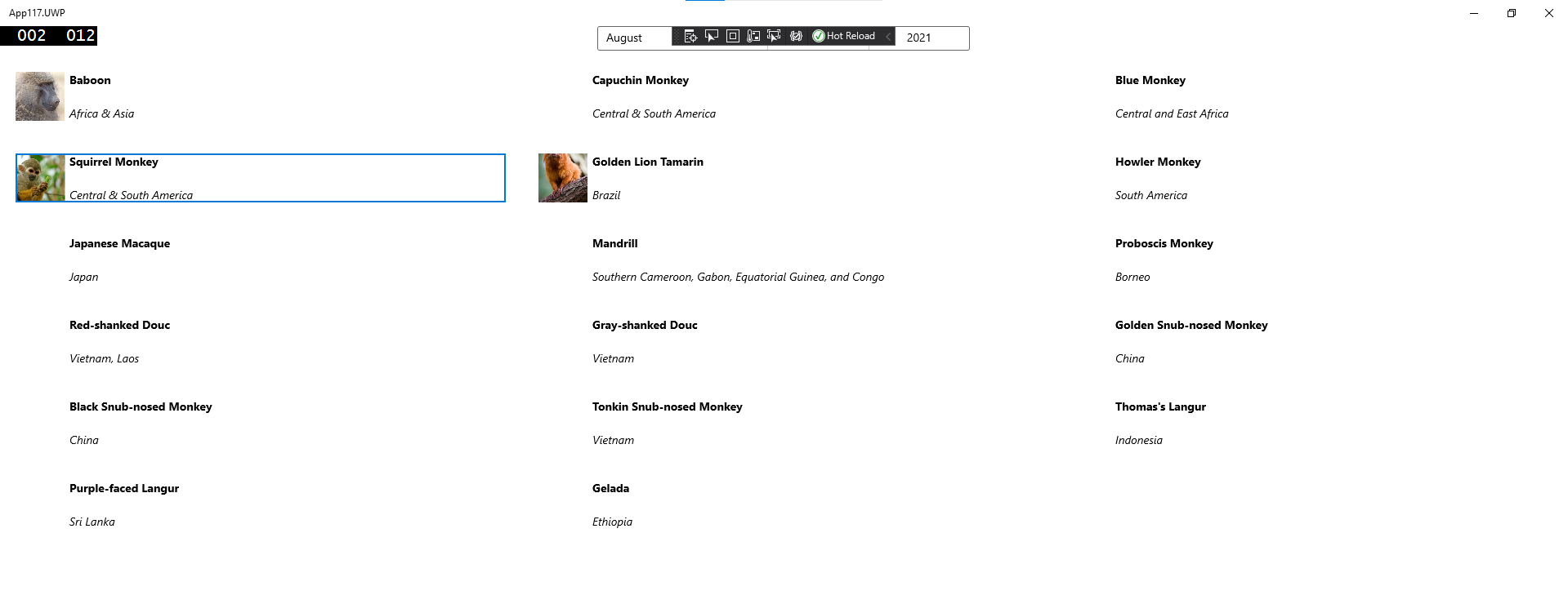

    Here is workaround to achieve the same result, you can achieve it in the background code with OnSizeAllocated method(PS, MyCol is X:Name of CollectionView) .
       public partial class MainPage : ContentPage
               GridItemsLayout gridItemsLayout;
               LinearItemsLayout linearItemsLayout;
               public MainPage()
                   InitializeComponent();
                   this.BindingContext = new MonkeysViewModel();
                   gridItemsLayout = new GridItemsLayout(3, ItemsLayoutOrientation.Vertical) { HorizontalItemSpacing=20, VerticalItemSpacing=20 };
                   linearItemsLayout = new LinearItemsLayout(ItemsLayoutOrientation.Vertical) { ItemSpacing = 20 };
               protected override void OnSizeAllocated(double width, double height)
                   base.OnSizeAllocated(width, height);
                   if (width >= 800)
                       Console.WriteLine("---ddddddd----");
                       MyCol.ItemsLayout = gridItemsLayout;
                      // MyCol.BackgroundColor = Color.Red;
                   else if(width<800 && width>0)
                       MyCol.ItemsLayout = linearItemsLayout;
                       Console.WriteLine("---aaaaaaa----");
                   //    MyCol.BackgroundColor = Color.Blue;
    Update=======================

    You could try to use following method for reusability.
    Firstly, we can create a BaseCollectionViewPage, then add CollectionView to xaml and background code.(PS: I find use SizeChanged method of Contentpage could achieve it as well). we do not need to bindingContext in the BaseCollectionViewPage.
    Here is BaseCollectionViewPage.xaml

    Then we can use it in needed pages. For example, my MainPage need to use it. so we change the ContentPage to local:BaseCollectionViewPage
       <?xml version="1.0" encoding="utf-8" ?>
       <local:BaseCollectionViewPage
                    xmlns:local="clr-namespace:App117"
                    xmlns="http://xamarin.com/schemas/2014/forms"
                    xmlns:x="http://schemas.microsoft.com/winfx/2009/xaml"
                    x:Class="App117.MainPage">
           <ContentPage.Resources>
           </ContentPage.Resources>
       </local:BaseCollectionViewPage>
    And add bindingContext,change the change the ContentPage to BaseCollectionViewPage in the background code. I give my full of background code, you can test it in your side

                       ImageUrl = "https://upload.wikimedia.org/wikipedia/commons/thumb/0/0b/Cuc.Phuong.Primate.Rehab.center.jpg/320px-Cuc.Phuong.Primate.Rehab.center.jpg"
                   source.Add(new Monkey
                       Name = "Golden Snub-nosed Monkey",
                       Location = "China",
                       Details = "The golden snub-nosed monkey is an Old World monkey in the Colobinae subfamily. It is endemic to a small area in temperate, mountainous forests of central and Southwest China. They inhabit these mountainous forests of Southwestern China at elevations of 1,500-3,400 m above sea level. The Chinese name is Sichuan golden hair monkey. It is also widely referred to as the Sichuan snub-nosed monkey. Of the three species of snub-nosed monkeys in China, the golden snub-nosed monkey is the most widely distributed throughout China.",
                       ImageUrl = "https://upload.wikimedia.org/wikipedia/commons/thumb/c/c8/Golden_Snub-nosed_Monkeys%2C_Qinling_Mountains_-_China.jpg/165px-Golden_Snub-nosed_Monkeys%2C_Qinling_Mountains_-_China.jpg"
                       Name = "Black Snub-nosed Monkey",
                       Location = "China",
                       Details = "The black snub-nosed monkey, also known as the Yunnan snub-nosed monkey, is an endangered species of primate in the family Cercopithecidae. It is endemic to China, where it is known to the locals as the Yunnan golden hair monkey and the black golden hair monkey. It is threatened by habitat loss. It was named after Bishop Félix Biet.",
                       ImageUrl = "https://upload.wikimedia.org/wikipedia/commons/thumb/5/59/RhinopitecusBieti.jpg/320px-RhinopitecusBieti.jpg"
                       Name = "Tonkin Snub-nosed Monkey",
                       Location = "Vietnam",
                       Details = "The Tonkin snub-nosed monkey or Dollman's snub-nosed monkey is a slender-bodied arboreal Old World monkey, endemic to northern Vietnam. It is a black and white monkey with a pink nose and lips and blue patches round the eyes. It is found at altitudes of 200 to 1,200 m (700 to 3,900 ft) on fragmentary patches of forest on craggy limestone areas. First described in 1912, the monkey was rediscovered in 1990 but is exceedingly rare. In 2008, fewer than 250 individuals were thought to exist, and the species was the subject of intense conservation effort. The main threats faced by these monkeys is habitat loss and hunting, and the International Union for Conservation of Nature has rated the species as \"critically endangered\".",
                       ImageUrl = "https://upload.wikimedia.org/wikipedia/commons/thumb/9/9c/Tonkin_snub-nosed_monkeys_%28Rhinopithecus_avunculus%29.jpg/320px-Tonkin_snub-nosed_monkeys_%28Rhinopithecus_avunculus%29.jpg"
                       Name = "Thomas's Langur",
                       Location = "Indonesia",
                       Details = "Thomas's langur is a species of primate in the family Cercopithecidae. It is endemic to North Sumatra, Indonesia. Its natural habitat is subtropical or tropical dry forests. It is threatened by habitat loss. Its native names are reungkah in Acehnese and kedih in Alas.",
                       ImageUrl = "https://upload.wikimedia.org/wikipedia/commons/thumb/3/31/Thomas%27s_langur_Presbytis_thomasi.jpg/142px-Thomas%27s_langur_Presbytis_thomasi.jpg"
                       Name = "Purple-faced Langur",
                       Location = "Sri Lanka",
                       Details = "The purple-faced langur, also known as the purple-faced leaf monkey, is a species of Old World monkey that is endemic to Sri Lanka. The animal is a long-tailed arboreal species, identified by a mostly brown appearance, dark face (with paler lower face) and a very shy nature. The species was once highly prevalent, found in suburban Colombo and the \"wet zone\" villages (areas with high temperatures and high humidity throughout the year, whilst rain deluges occur during the monsoon seasons), but rapid urbanization has led to a significant decrease in the population level of the monkeys.",
                       ImageUrl = "https://upload.wikimedia.org/wikipedia/commons/thumb/0/02/Semnopithèque_blanchâtre_mâle.JPG/192px-Semnopithèque_blanchâtre_mâle.JPG"
                       Name = "Gelada",
                       Location = "Ethiopia",
                       Details = "The gelada, sometimes called the bleeding-heart monkey or the gelada baboon, is a species of Old World monkey found only in the Ethiopian Highlands, with large populations in the Semien Mountains. Theropithecus is derived from the Greek root words for \"beast-ape.\" Like its close relatives the baboons, it is largely terrestrial, spending much of its time foraging in grasslands.",
                       ImageUrl = "https://upload.wikimedia.org/wikipedia/commons/thumb/1/13/Gelada-Pavian.jpg/320px-Gelada-Pavian.jpg"
                   Monkeys = new ObservableCollection<Monkey>(source);
               void FilterItems(string filter)
                   var filteredItems = source.Where(monkey => monkey.Name.ToLower().Contains(filter.ToLower())).ToList();
                   foreach (var monkey in source)
                       if (!filteredItems.Contains(monkey))
                           Monkeys.Remove(monkey);
                       else
                           if (!Monkeys.Contains(monkey))
                               Monkeys.Add(monkey);
               void MonkeySelectionChanged()
                   SelectedMonkeyMessage = $"Selection {selectionCount}: {SelectedMonkey.Name}";
                   OnPropertyChanged("SelectedMonkeyMessage");
                   selectionCount++;
               void RemoveMonkey(Monkey monkey)
                   if (Monkeys.Contains(monkey))
               void FavoriteMonkey(Monkey monkey)
                   //  monkey.IsFavorite = !monkey.IsFavorite;
               #region INotifyPropertyChanged
               public event PropertyChangedEventHandler PropertyChanged;
               void OnPropertyChanged([CallerMemberName] string propertyName = null)
                   PropertyChanged?.Invoke(this, new PropertyChangedEventArgs(propertyName));
               #endregion
    Best Regards,
    Leon Lu
