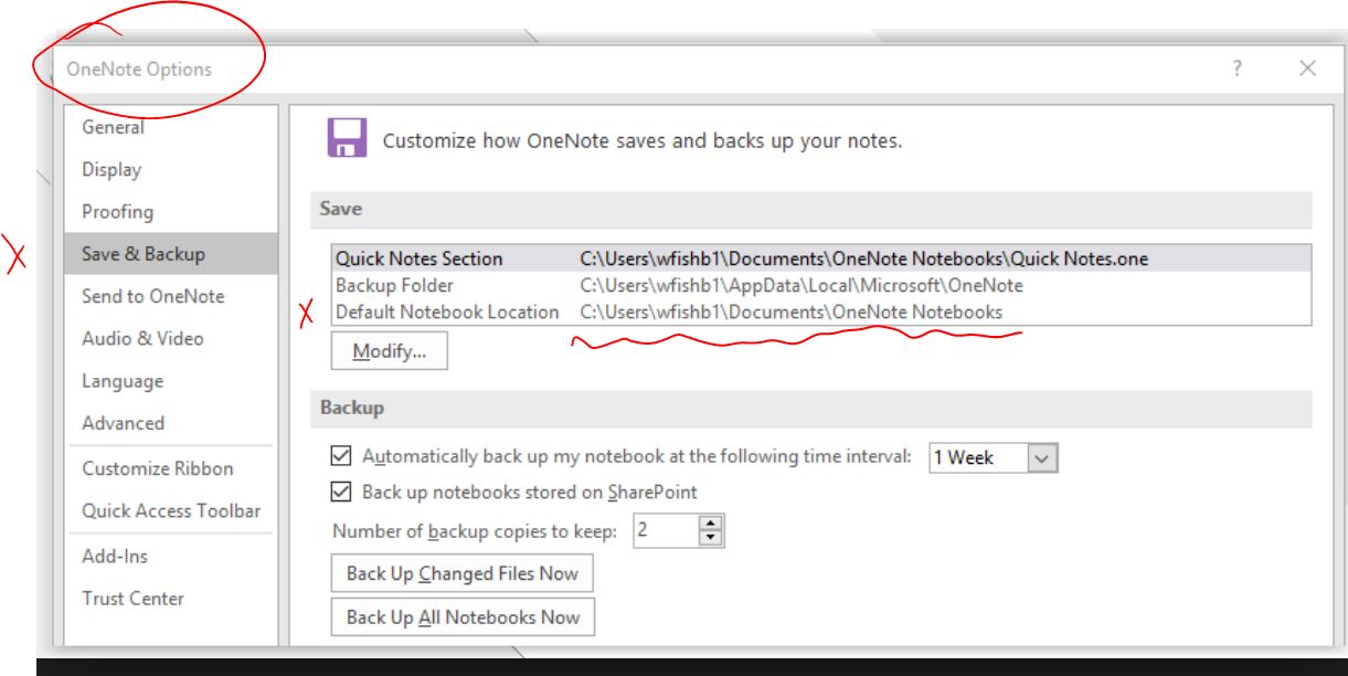

    The OneNote default folder for new notebooks can be set or seen in the Options:

    As long as you use OneNote 201x, not the builtin OneNote for Windows (the OneNote without a File menu) you have a local backup. Where it is you can see in my screenshot.
